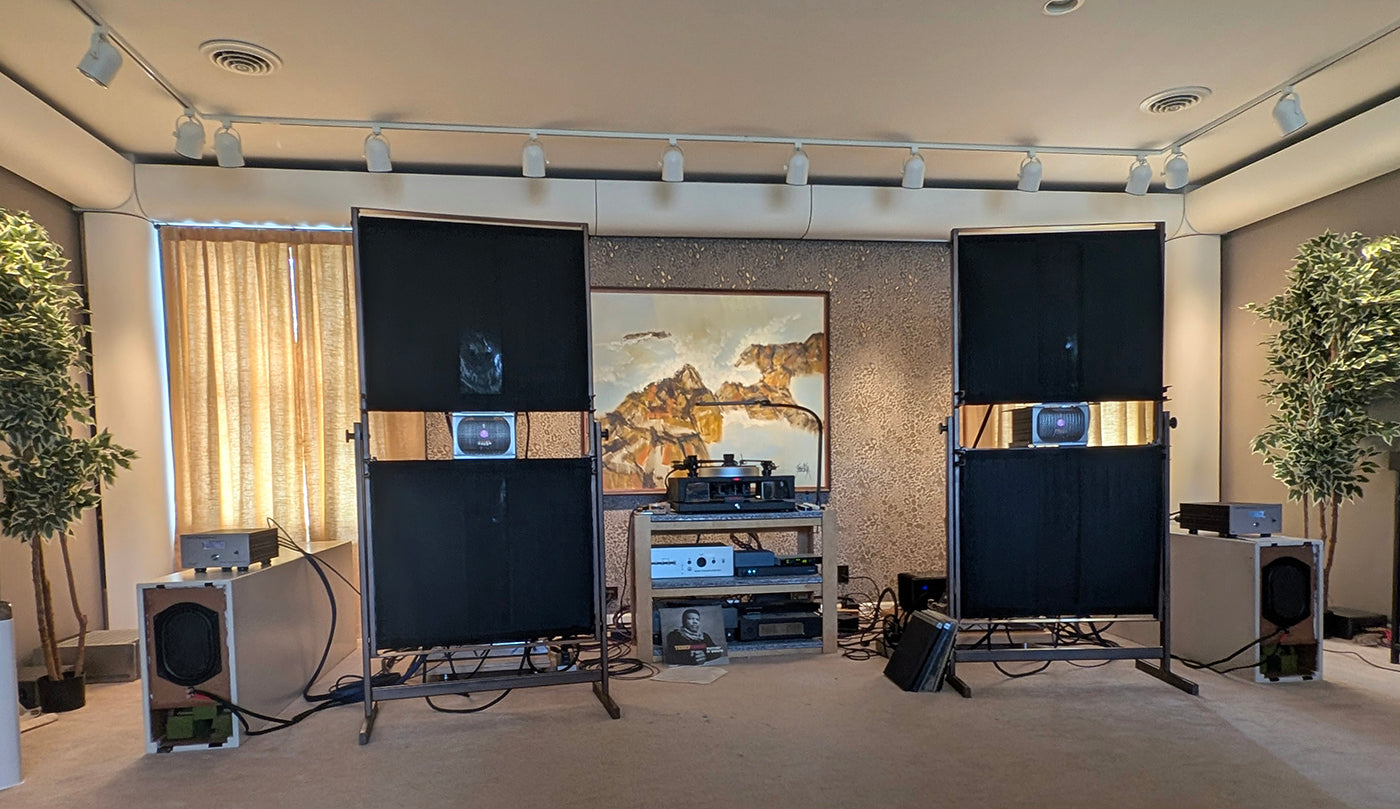

Before I wax poetic about it, some tech: The Quad speakers are stacked two per side, with the bottom speaker oriented upside down from the top one. The Plasmatronics tweeter is mounted in the middle. All are housed in a custom adjustable metal frame designed by Brian. The analog source consisted of a Dohmann Audio Helix One Mk3 turntable with Supatrac Blackbird arm and Symphonic Line RG8 Gold cartridge, going through an Atma-Sphere MP-1 preamp.
The Quads are driven in series by Atma-Sphere MA-1 OTL (output transformerless) amps, while the Plasmatronics tweeters are supplied with their own high-power MOSFET amps designed by Tony Salsich. The low frequencies are handled by a pair of Fried “coffin” transmission line subwoofers with KEF B139 bass drivers. The subs are driven by PS Audio BHK 300 mono amps.
