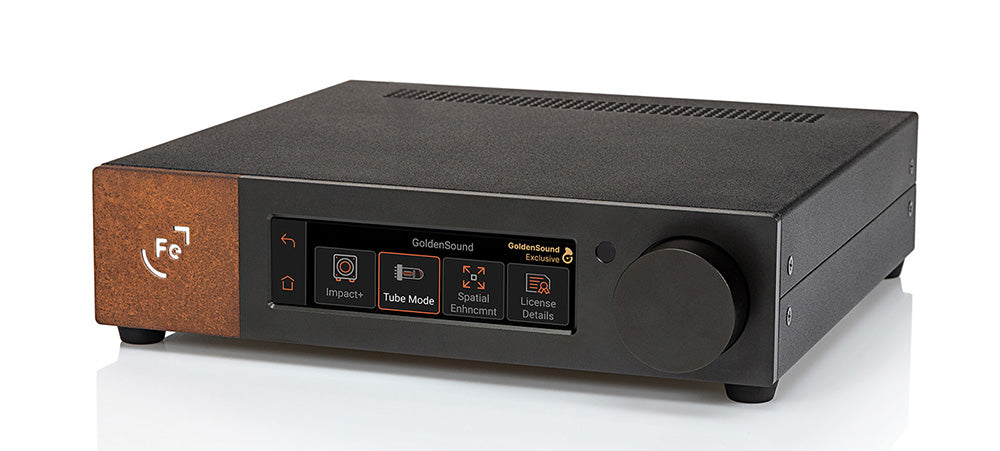

In Part Two of my CanJam NYC 2026 coverage (Issue 230) I promised to tell you about the most interesting audio component I’ve come across in years: the Ferrum Audio WANDLA Golden Sound Edition Gen 2 DAC. That’s because of its unique DSP processing, which includes spatial enhancement, low-frequency tailoring, selectable digital filtering, and the feature that grabbed me and didn’t let go – their Gen 2 Tube Mode.

I was so intrigued by the WANDLA Golden Sound Edition Gen 2 DAC ($3,695) that I asked to borrow one. I wanted to hear the Gen 2 Tube Mode in my main and desktop systems at home. Well, my listening confirmed what I heard at CanJam NYC. The WANDLA added various degrees of very pleasing warmth, and a greater sense of presence to instruments like tenor and alto sax, which had that elusive “creaminess” that I really need in an audio system. Female vocals were heavenly. I spent an afternoon listening to Samara Joy and had difficulty tearing myself away.The WANDLA Golden Sound Edition Gen 2 DAC offers a variety of tube flavors to choose from.
Of course I listened in “straight” mode. It sounded superb, as the WANDLA is a really excellent DAC, with features like their proprietary Gen 2 Serce (Polish for “heart”) digital audio system module, digital filters from specialist supplier Signalyst, a choice of digital or analog volume control, and a whole lot more packed into its compact chassis. In “straight” mode with no effects, the WANDLA sounds sweet and detailed and spacious and excellent, without a trace of digital artifacts.
But…I found myself drawn to that Gen 2 Tube Mode feature, in particular to the 300B emulation at about 120 percent (on a scale from 0 to 200). It added an alluring richness, maybe at the expense of some fine musical detail (and maybe not), a tradeoff I was more than willing to accept.

I received replies from Roy Feldstein and Pawel Gorgon, Ferrum's vice president and chief R&D engineer. Roy noted, “These added capabilities are made possible by Serce. The Serce module, which incorporates a dual-core ARM chip, handles all signal processing and digital filtering. Ferrum sells Serce modules to other manufacturers, including one in the US.”
Pawel added, “We tested amplifiers built with specific tubes, and measured their harmonic distortion. We played a 1 kHz signal and measured each harmonic level on an FFT [fast Fourier transform analyzer]. Then we used some math: trigonometric formulas for sin to powers 2 to 7 (2nd, 3rd, 4th, 5th, 6th, 7th) and their reduced forms. We got six formulas, which we transformed into final formulas for calculating coefficients to achieve the required levels of each harmonic.
Having this, we implemented simulations in Python [audio software], where we were able to change the level of each harmonic separately, put all of them into our formulas, and then into our algorithm, and check [to see] if it worked. It sure did.”
Gorgon added, “What is important is that the 32-bit input sample remains untouched, and scaled harmonics are just added to it, so the whole operation has no negative impact on overall audio quality and, at the same time, produces tube-colored sound.”

The WANDLA measures about 9 by 8 by 2 inches.
