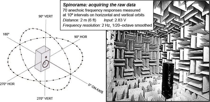

Of course, there are limitations with Spinorama information. The main thing to keep in mind is that every room will massively influence the sound heard from the loudspeakers, each room imposing itself on the sound in its own unique way. Additionally, it’s important to remember that the Spinorama data itself is collected from the speaker’s behavior when measured in an anechoic chamber, a controlled acoustic environment which is very different from any room in which a speaker will be listened to. That said, it would be impossible to collect the extremely useful Spinorama data any other way. (Others have attempted Spinorama measurements in rooms other than anechoic chambers and have had to add caveats to their measurements as a result.) You could perhaps think of the Spinorama data as akin to the manufacturer’s specifications for a vehicle’s mileage ratings. When you drive your car, it’s likely that the routes you drive on won’t match the manufacturer’s test conditions. Yes – your mileage may vary. But this does not invalidate the value of the specifications provided by the car’s manufacturer, in the same way that Spinorama measurements will be a valid indicator of a speaker’s performance. One could hope that the use of Spinorama will become more prevalent in the industry and among reviewers. An experiment worth trying out, which I have found to be very supportive of the value of Spinorama data, is to listen to a demonstration of, say, three or more different sets of speaker pairs (if the audio salon will accommodate you). I find it’s easier to compare just a few at a time, for the sake of recalling details and mental notes. (In an ideal world you would conduct the test under double-blind conditions to enable non-visually influenced assessments.) Take note of the speakers you like the most and simply rank them. When you return home, look up the Spinorama data for each, if it exists of course, and see for yourself if the best-sounding speakers conform to the Spinorama data indicating which would be best. You may be encouraged to discover that the speakers you enjoyed the most did in fact follow the desirable characteristics in their measurement plots, whereas those you disliked did not. I will have a little more to say about this experiment in a future article. As always, enjoy your listening-comparison experiments with music that is most familiar and well-known to you in its nuances, whether focusing on the vocals, drums, woodwinds, strings, or each in turn. It’s all part of striving towards a positive listening experience. It’s worth the proportionately small investment of time compared to the many years of listening pleasure you will likely derive from your speakers.
