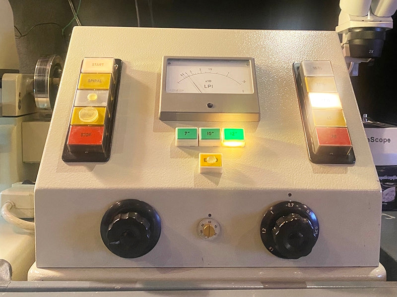

Header image: The "pitch box of a Neumann VMS-70 lathe, from where the recording pitch could be monitored and adjusted. A couple of motors and a differential lived under this box, driving the leadscrew of the lathe, which would advance the carriage, suspension box and cutter head across the lacquer disk.
Photo courtesy of Greg Reierson of Rare Form Mastering, Minneapolis, Minnesota.
