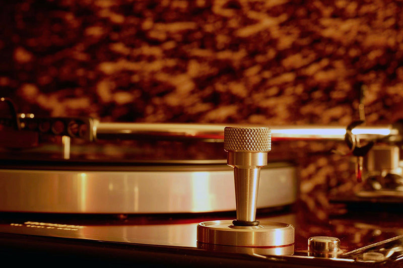

Many vinyl records are manufactured with an oversize spindle hole, and some turntables have undersized spindles. These conditions can result in pitch variation from not being able to center the record onto the spindle, which causes eccentric rather than concentric rotation of the record. To solve the problem, I created a custom record centering accessory, intended as a quick and simple way of centering vinyl records with oversize center holes.
This compact and lightweight accessory is simply placed on the center spindle of your turntable over the record and twisted into position, which locates the sharp edge of the device between the spindle and the record hole, taking up any excessive clearance.
The bore and conical outer surface of the centering accessory are concentric within 0.00002 of an inch (0.5 µm), ensuring that the center hole of the record is perfectly concentric with the spindle.

The record centering device in use.
