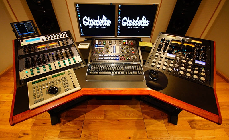

Stardelta Audio Mastering. From the Hutchinson Homes & Gardens website.
