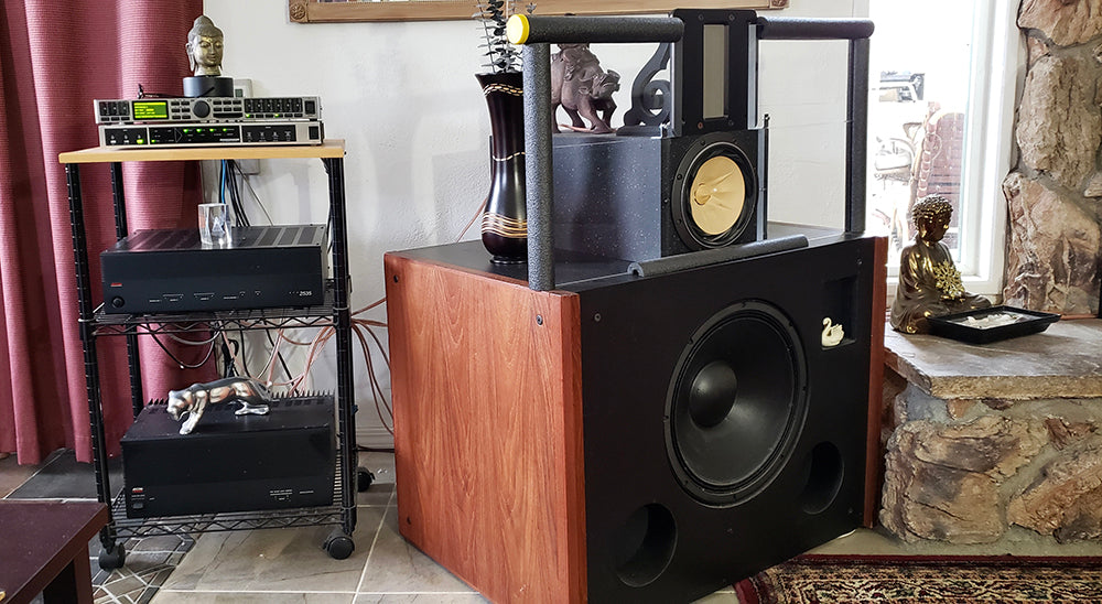

Once I had the drivers, it was time to acquire the cabinets. I’d planned to construct them myself, but with a stroke of luck, I came across a pair of 7-cubic-foot bass bins originating from a recording studio. They weigh over 200 lbs. each and are much better built than my limited carpentry skills and equipment would allow. All I had to do was tailor the ports and internal damping to my Italian drivers.
The ports were easy, there are formulas for that.
The internal damping took several months. Too much and the sound was lifeless. Too little and the bass sounded like it was coming from a bathroom. I tried foam, shredded cotton, wool felt, and various types of fiberglass damping material. The most natural bass resulted from employing 2-inch Owens Corning 705 high-density fiberglass. This is the yellow stuff often found behind ovens and fridges (nasty to work with; wear gloves and a respirator). I covered all four interior surfaces of the bin, and placed a large piece across the diagonal to discourage standing waves.
The midrange boxes are re-purposed EPI 100 loudspeaker cabinets. I removed the drivers, covered the baffle with MDF, and laid them face down. Then I cut a hole in what was the top to accommodate my 8-inch midrange driver. There is a similar hole in the other end (backside). The cabinets are stuffed with increasing-density damping material like a transmission line. That way, the back waves have no opportunity to reflect back into the lightweight cone to cause distortion.
The heavy ribbon tweeter is simply set on top of the midrange driver and braced. Being a line source, it has controlled vertical dispersion. This design keeps high frequencies from bouncing off the ceiling and floor.
Diffraction causes sound waves to re-radiate from cabinet edges and splash off nearby surfaces. It makes drivers sound muddy. The custom-cut plexiglass baffles in the photo extends the baffle size and drops the diffraction frequencies to a point below where they are most audible.  The foam trim mitigates the remaining diffraction.
The wide baffles also direct the sound energy towards the listener for superior dynamics. A light bulb mounted against a white wall (rather than hung in the middle of the room) directs light in the same way.

My goal was to re-create (in-home) a sound that most closely approximates the experience of a concert hall. I failed miserably. No one will ever mistake the sound in my little room for the glorious sound of a symphony hall. The laws of physics preclude it. But I got closer than any other system I’ve heard in an equivalently sized space.
B. Jan Montana's completed audio system.
