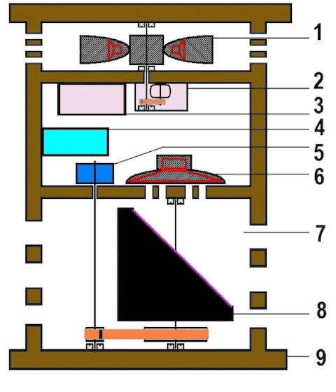

Header animation courtesy of Wikimedia Commons/Berndt Meyer. Pictured: 1) Horn enclosure. 2) Compression driver. 3) Treble motor. 4) Crossover, 5) Bass motor. 6) Woofer. 7) Drum enclosure. 8) Drum. 9) Cabinet. Amplifier not pictured.
