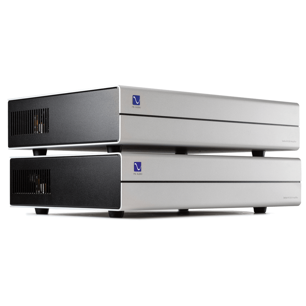

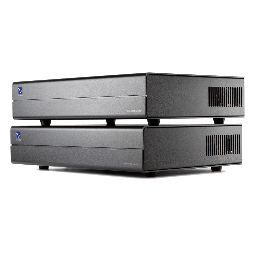

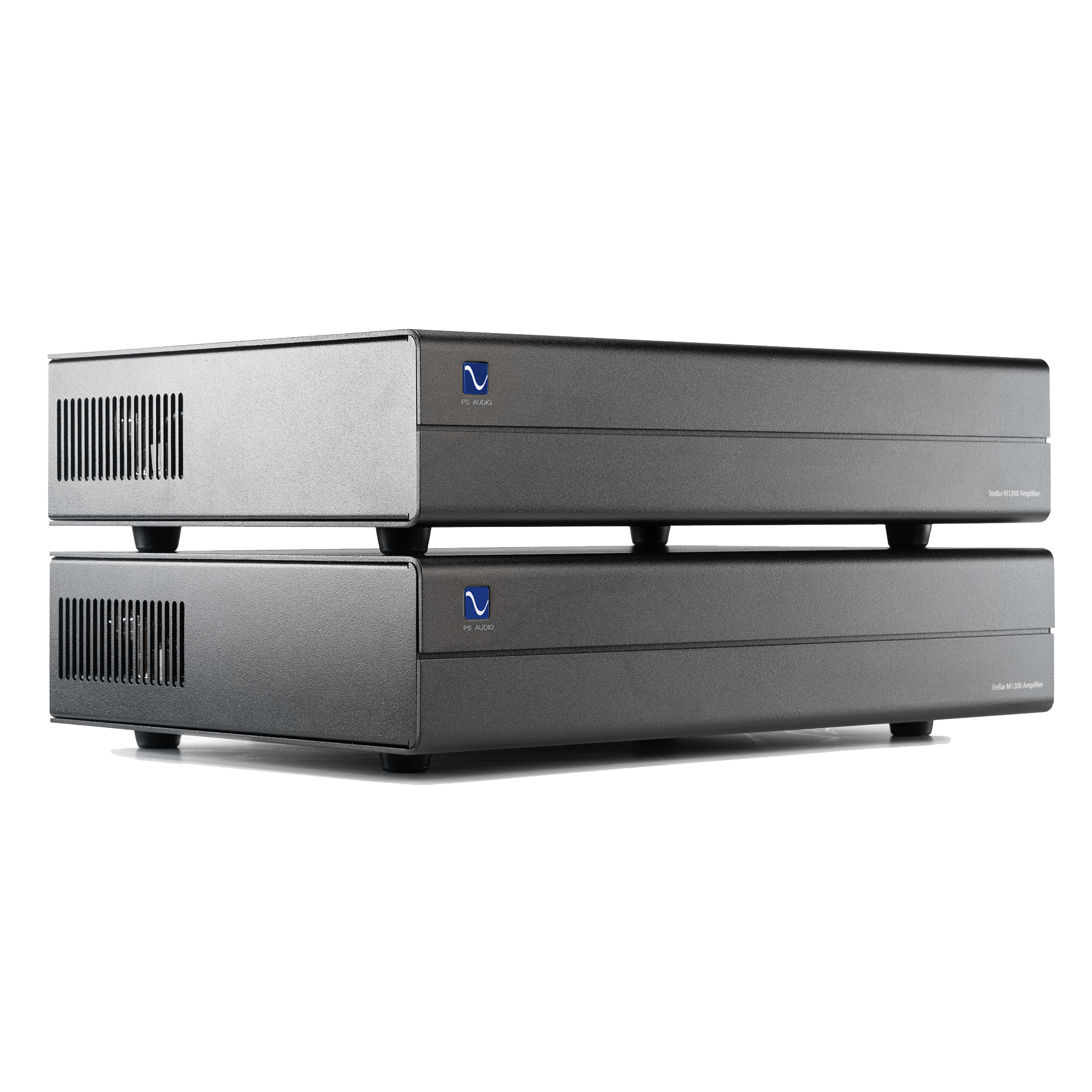

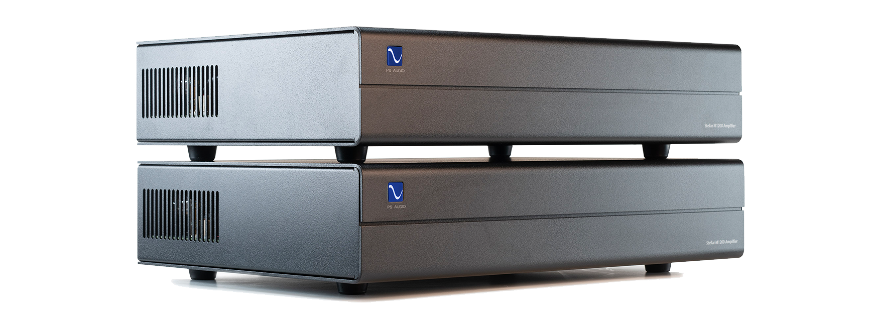

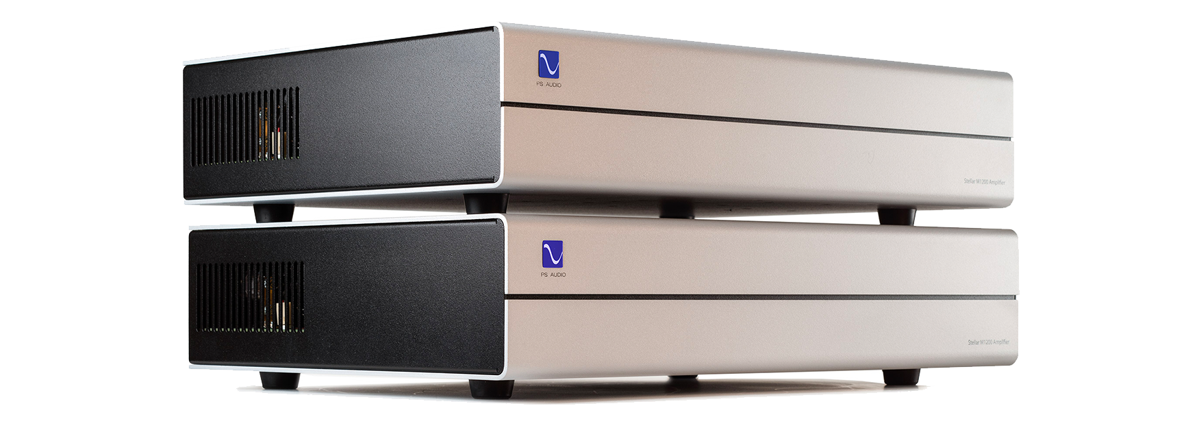

Designed for large or hard-to-drive speakers
- Power 600 W into 8Ω · 1,200 W into 4Ω
- Design Mono pair, one per speaker
- Vacuum tube input stage

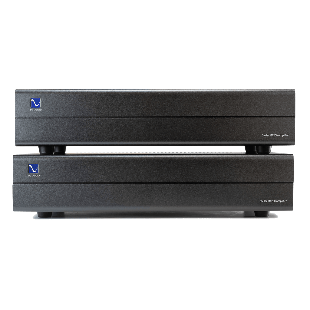

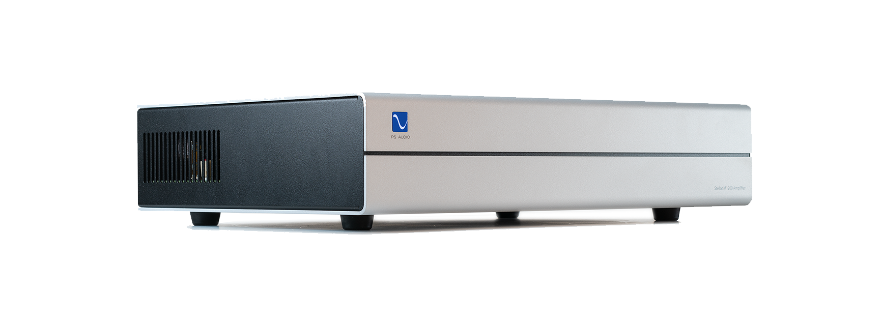

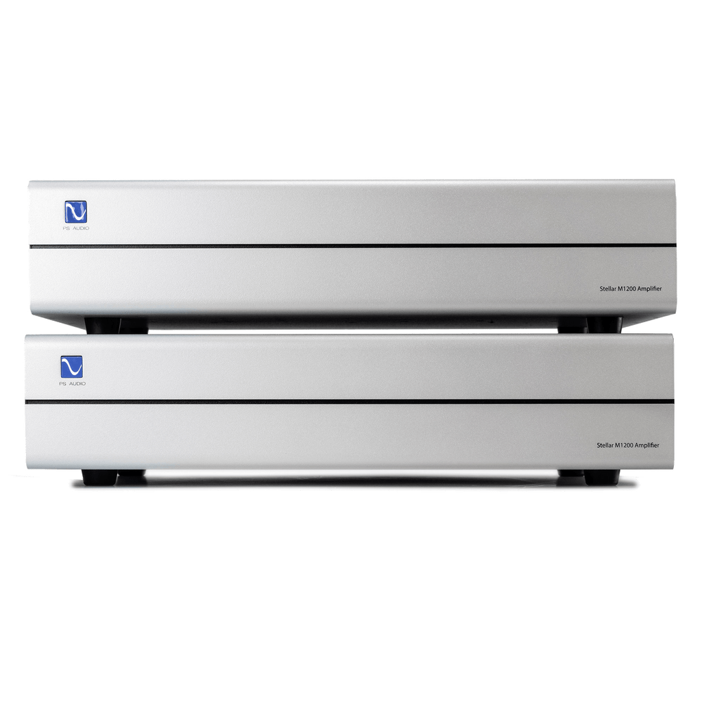

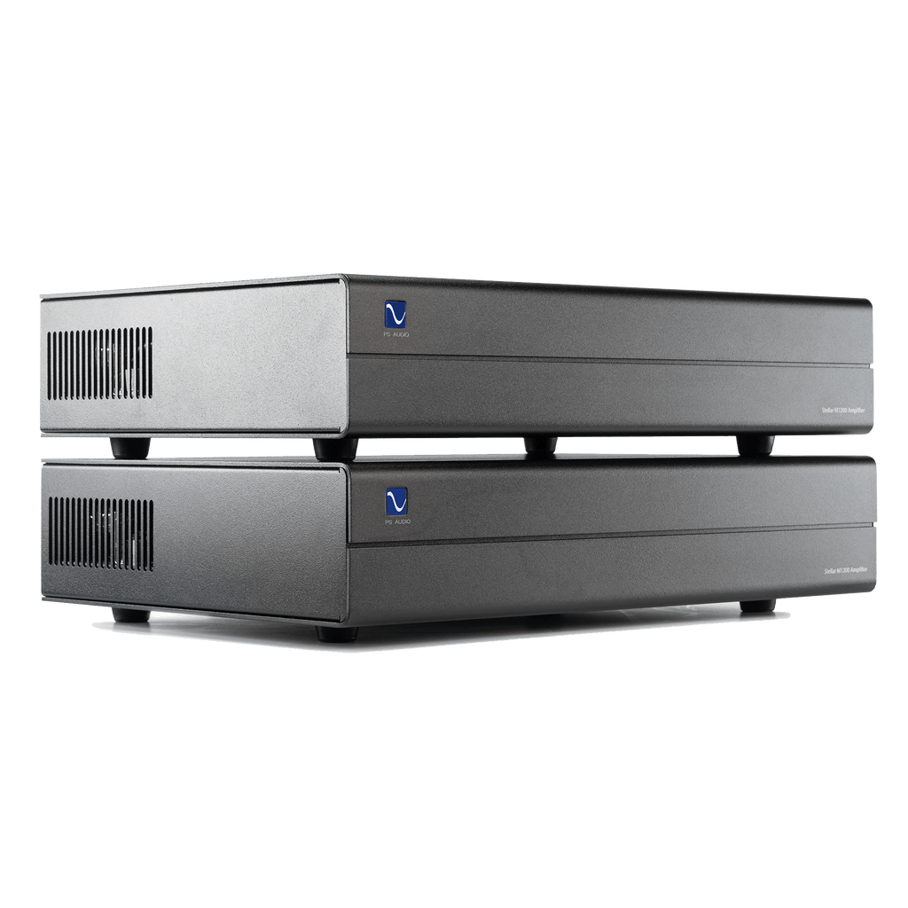

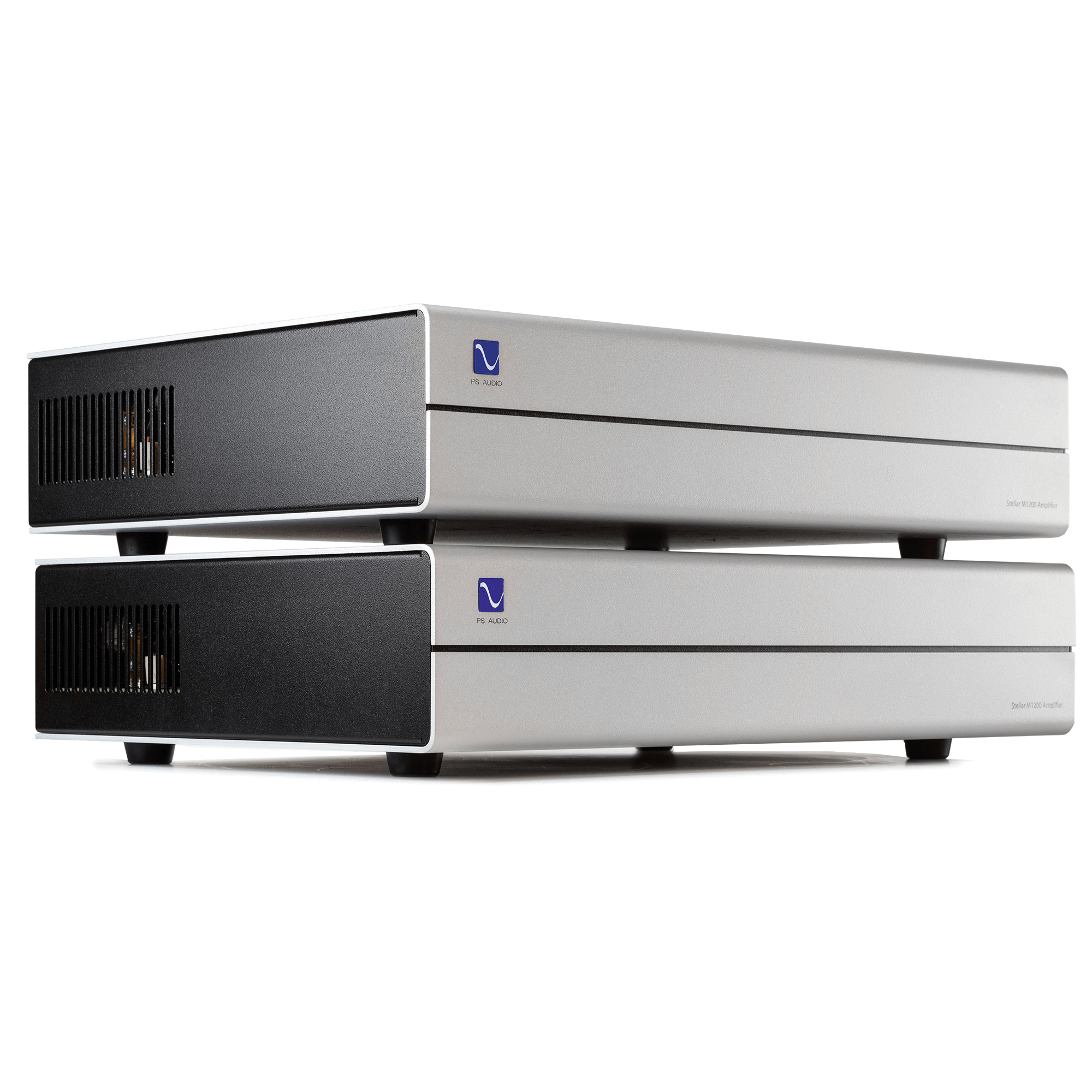

Features
At a glance
- Mono power amplifier pair
- Zero-loss tube input stage
- Powerful mosfet output stage
- Rca single ended input
- XLR "true" balanced input
- 600 watts per channel 8ω
- 1200 watts rms into 4ω
- 2ω stable
- Ice edge technology
- Damping factor > 1100
- Front panel standby button
- Very little heat production
- Dual, solid, copper plated output posts
- 27 lbs. each
Specifications
Full specifications

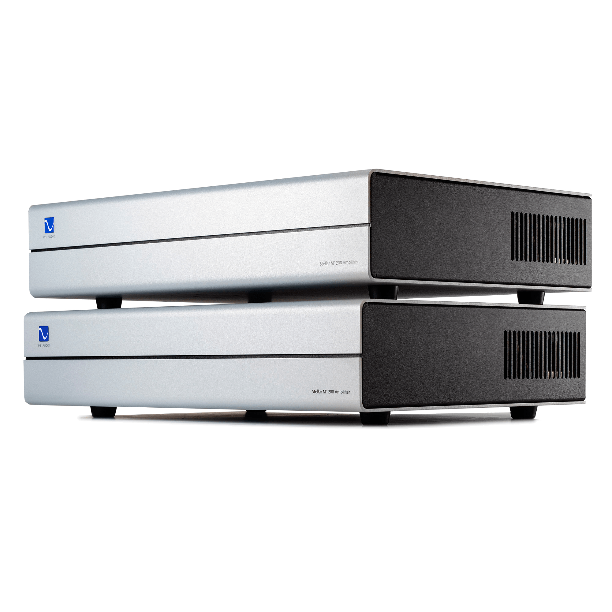

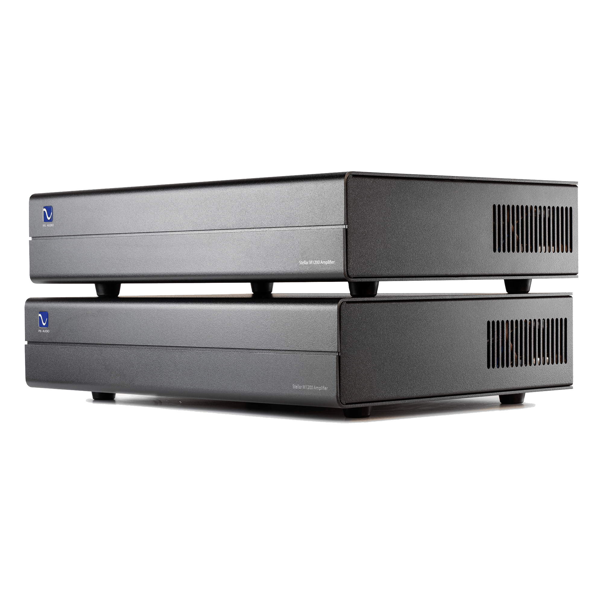

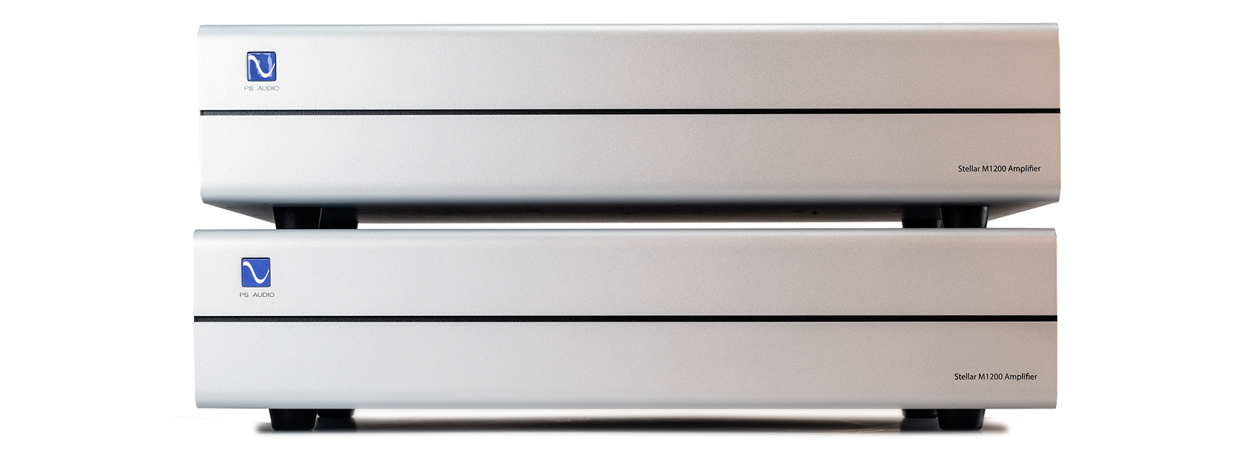

| Stellar M1200 Mono Amplifier | |
| Unit Weight | 27 lbs [12.2 kg] (each) |
| Unit Dimensions | 17”W x 3.75”H x 12”D (13"D w/connectors) 17”W x 7.5”H x 12”D (Stacked) |
| Shipping Weight | 29 lbs [13.15 kg] (each) |
| Shipping Dimensions | 22”W x 8”H x 17”D (each) |
| Color Options | Black Silver |
| Vacuum tube type | 12AU7 |
| Voltage Options (Factory set only) | Japan 100V North America 120V Europe/Asia/Australia/New Zealand 230V |

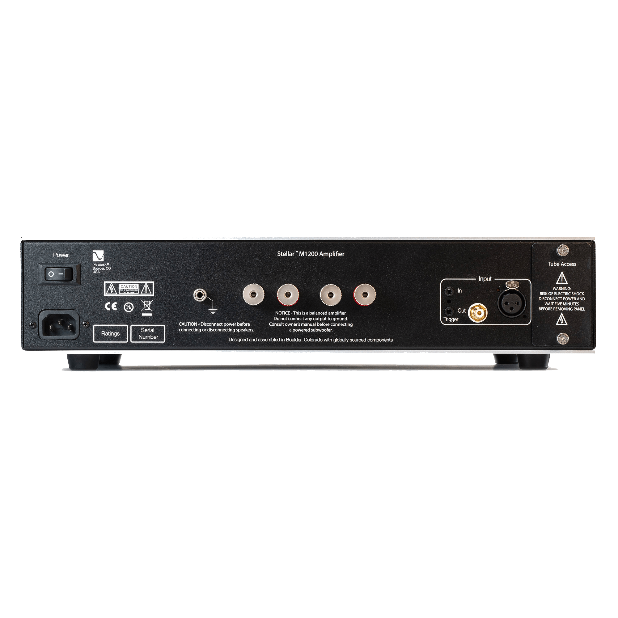

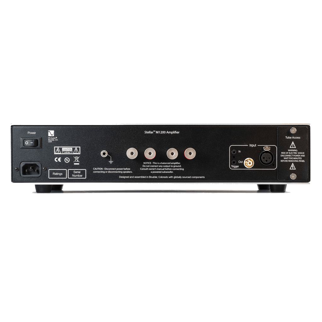

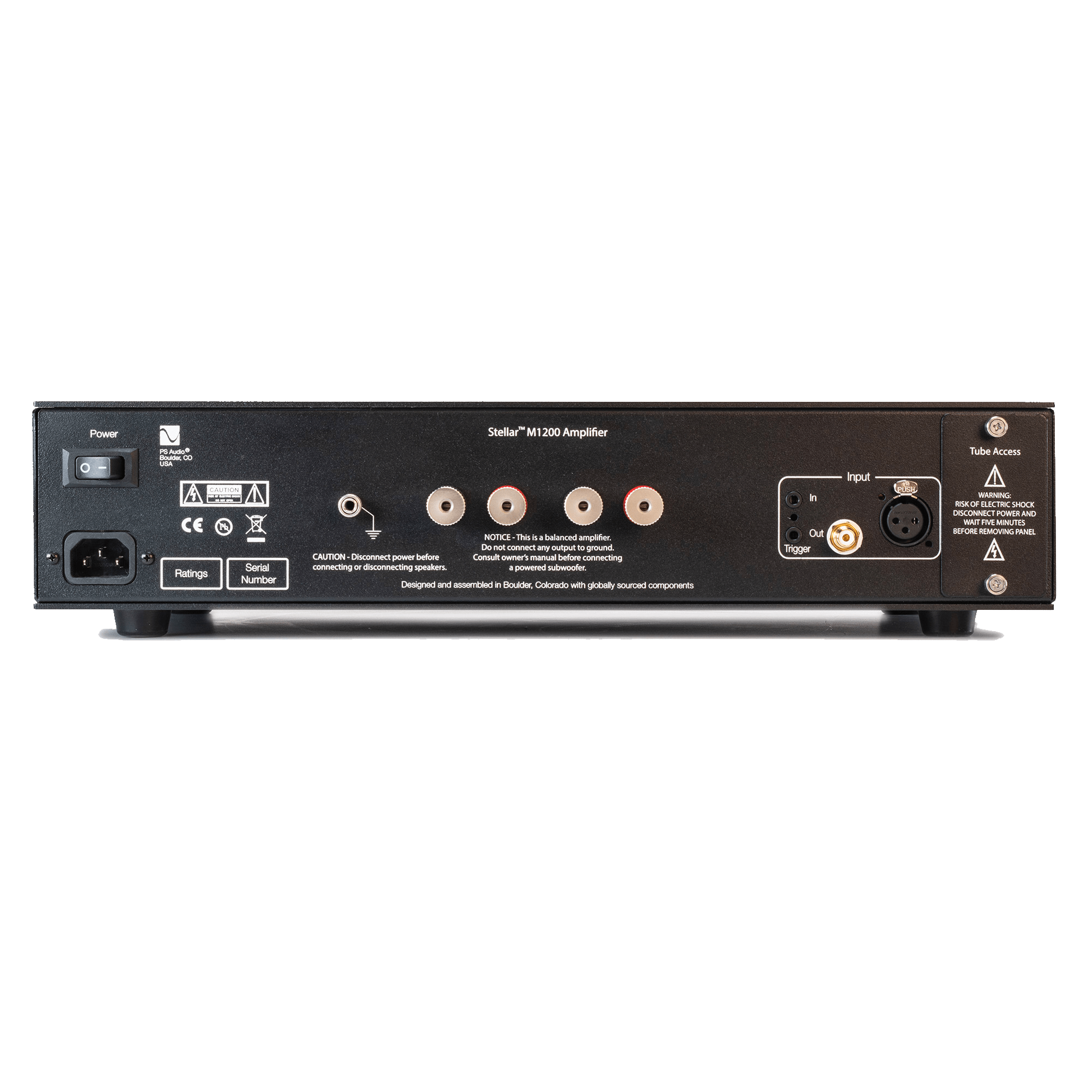

| Mains Power Inputs | IEC C14 |
| Idle Power Consumption | 27W |
| Power Factor | >0.9 @ rated power 4Ω |
| Accessories Included | US (NEMA 5-15P) (all versions) Schuko (CEE7/7) (230V version) UK (BS 1363) (230V version) |
| Audio Inputs | RCA (Unbalanced) XLR (Balanced) |
| Speaker Outputs | Copper base nickel plated binding posts (2 pair) |
| DC Trigger Input | 3.5mm 5-15VDC |
| Warranty | 3 years parts and labor |
| Signal | |
| Gain | 30.5dB +/-0.5dB |
| Sensitivity for rated output power | 2.08V |
| Signal to Noise | 1kHz@1200 Watts > 112dB |
| Input impedance | Unbalanced 50KΩ Balanced 100KΩ |
| Output Impedance | 50Hz, 2.8VRMS <0.007Ω |
| Damping factor | 50Hz. 2.8VRMS 8Ω >1100 4Ω >550 |
| Frequency Response | 2.8VRMS into 4Ω 10Hz – 20KHz +/- 0.5dB 10Hz – 45KHz +0.1/-3.0dB |
| THD & IM | |
| 1KHz, 1W/4Ω | < 0.005% |
| 10-20KHz, 1W/4Ω | < 0.01% |
| 1KHz, 150W/4Ω | < 0.02% |
| Output Power | 120vac mains, 1kHz, 1% THD |
| 8Ω | 600W minimum |
| 4Ω | 1200W minimum |
| 2Ω | Stable for musical transients |
