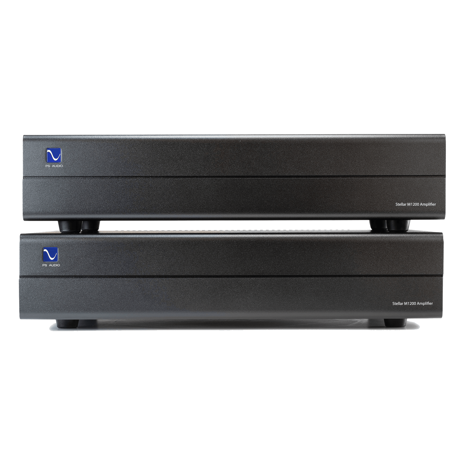

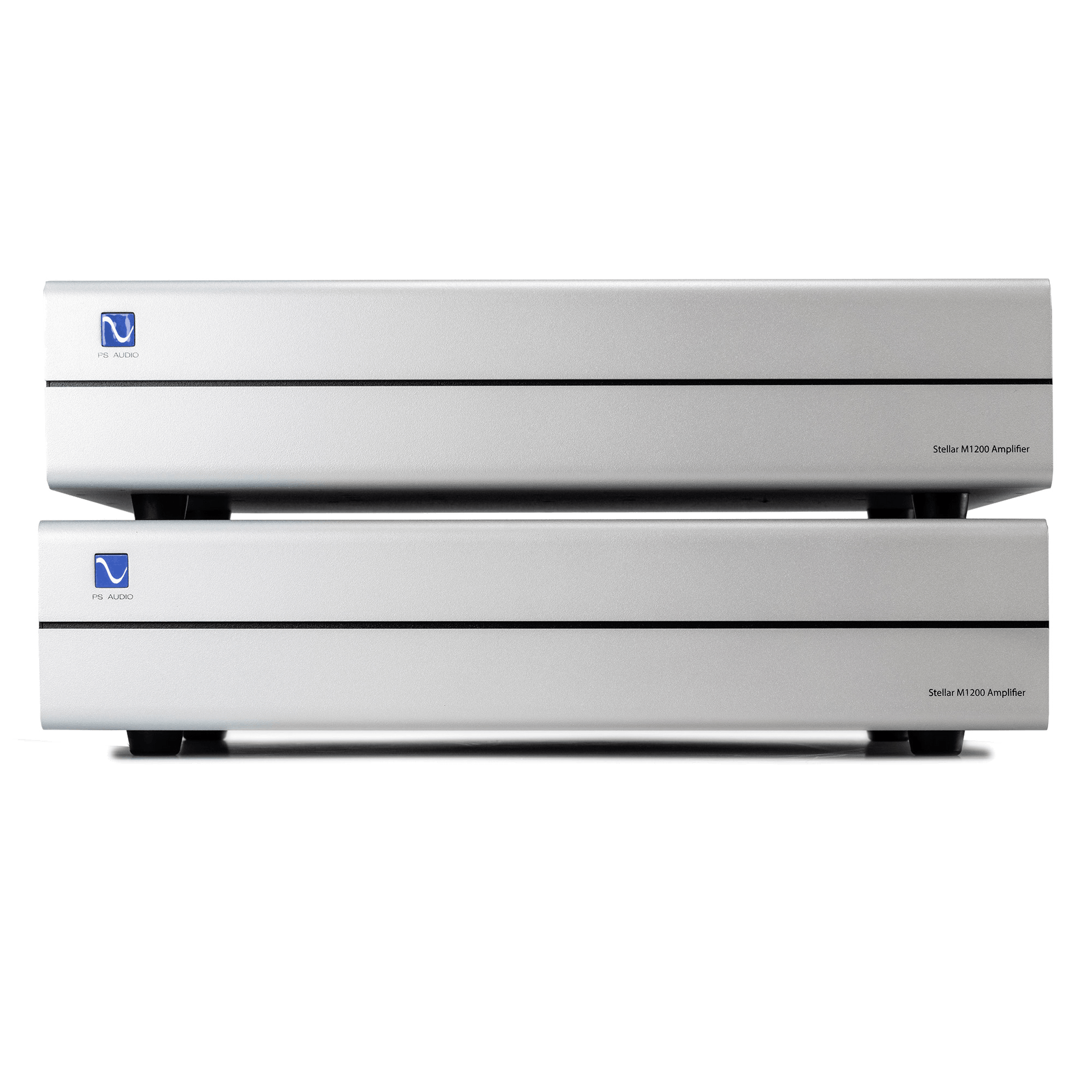

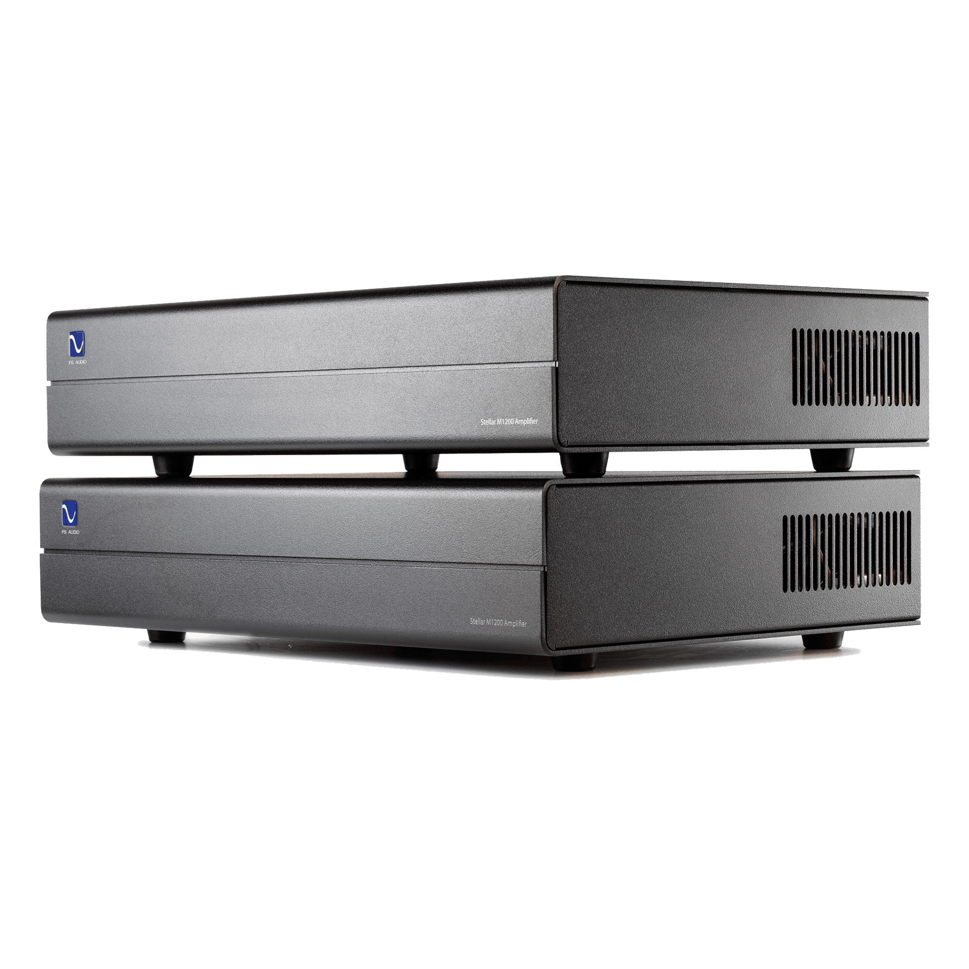

Designed for large or hard-to-drive speakers
  • Power 600 W into 8Ω · 1,200 W into 4Ω
  • Design Mono pair, one per speaker
  • Vacuum tube input stage

  • Mono power amplifier pair
  • Zero-loss tube input stage
  • Powerful mosfet output stage
  • Rca single ended input
  • XLR "true" balanced input
  • 600 watts per channel 8ω
  • 1200 watts rms into 4ω
  • 2ω stable
  • Ice edge technology
  • Damping factor > 1100
  • Front panel standby button
  • Very little heat production
  • Dual, solid, copper plated output posts
  • 27 lbs. each
Specifications
Full specifications

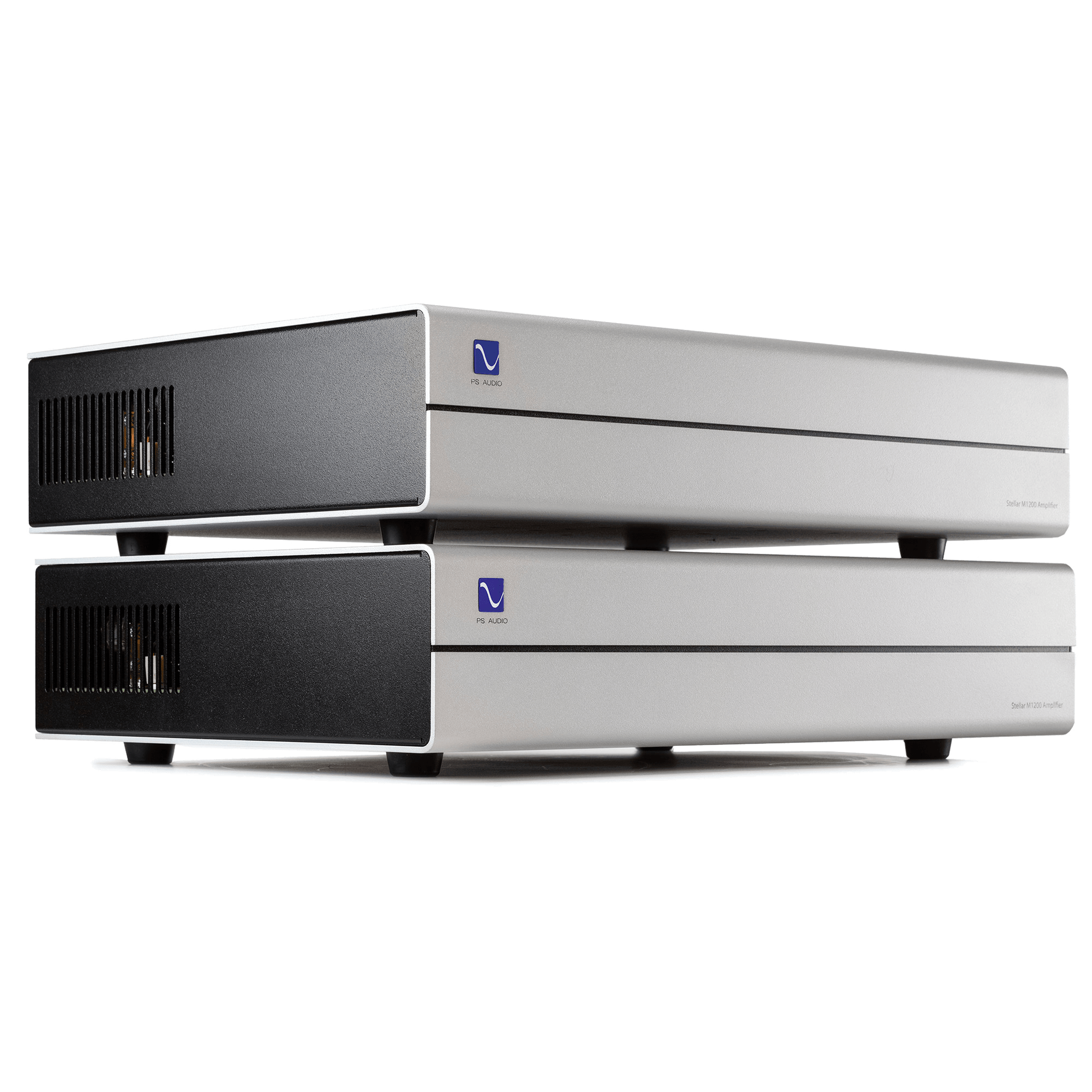

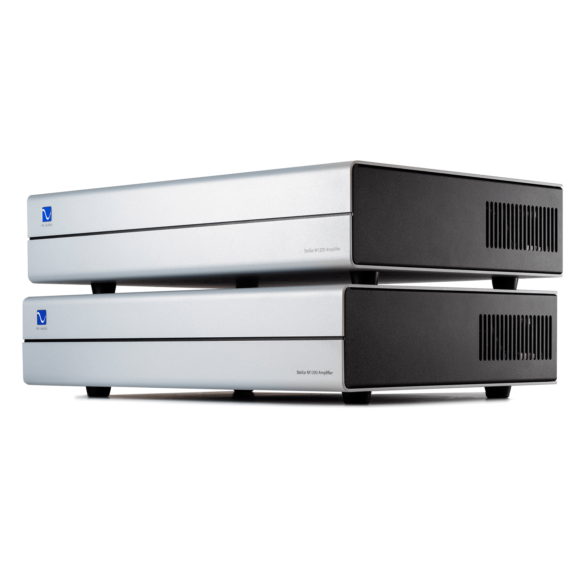

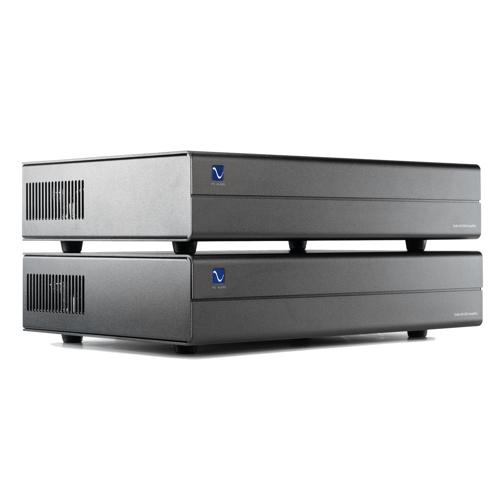

Stellar M1200 Mono Amplifier
Unit Weight27 lbs [12.2 kg] (each)
Unit Dimensions17”W x 3.75”H x 12”D (13"D w/connectors) 17”W x 7.5”H x 12”D (Stacked)
Shipping Weight29 lbs [13.15 kg] (each)
Shipping Dimensions22”W x 8”H x 17”D (each)
Color OptionsBlack Silver

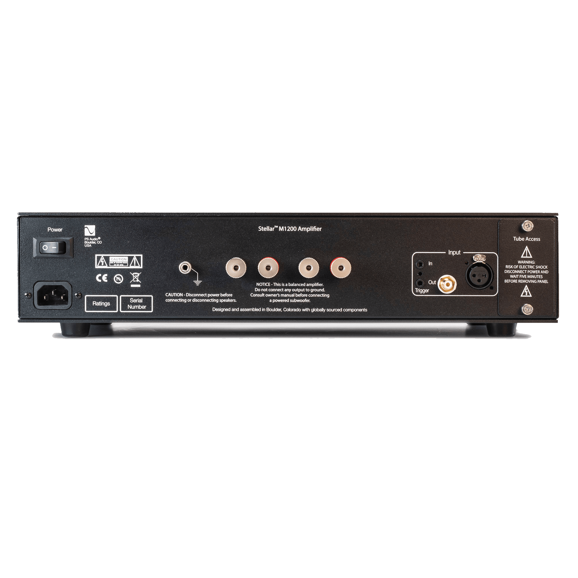

Vacuum tube type12AU7
Voltage Options (Factory set only)Japan 100V North America 120V Europe/Asia/Australia/New Zealand 230V
Mains Power InputsIEC C14
Idle Power Consumption27W
Power Factor>0.9 @ rated power 4Ω
Accessories IncludedUS (NEMA 5-15P) (all versions) Schuko (CEE7/7) (230V version) UK (BS 1363) (230V version)
Audio InputsRCA (Unbalanced) XLR (Balanced)
Speaker OutputsCopper base nickel plated binding posts (2 pair)
DC Trigger Input3.5mm 5-15VDC
Warranty3 years parts and labor
Signal
Gain30.5dB +/-0.5dB
Sensitivity for rated output power2.08V
Signal to Noise1kHz@1200 Watts > 112dB
Input impedanceUnbalanced 50KΩ Balanced 100KΩ
Output Impedance50Hz, 2.8VRMS <0.007Ω
Damping factor50Hz. 2.8VRMS 8Ω >1100 4Ω >550
Frequency Response2.8VRMS into 4Ω 10Hz – 20KHz +/- 0.5dB 10Hz – 45KHz +0.1/-3.0dB
THD & IM
1KHz, 1W/4Ω< 0.005%
10-20KHz, 1W/4Ω< 0.01%
1KHz, 150W/4Ω< 0.02%
Output Power120vac mains, 1kHz, 1% THD
8Ω600W minimum
4Ω1200W minimum
2ΩStable for musical transients

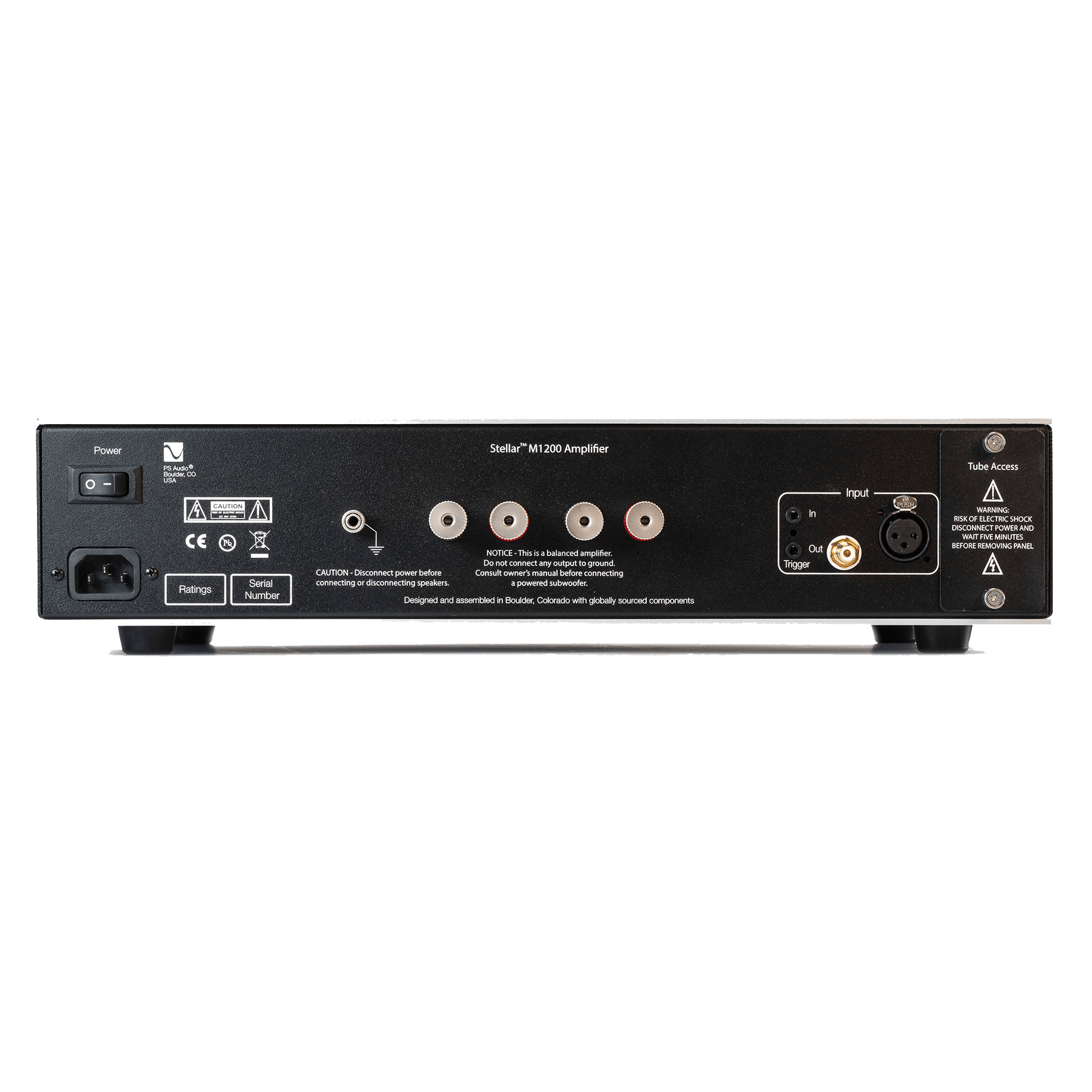

Mains Power Inputs IEC C14
Idle Power Consumption 27W
Power Factor >0.9 @ rated power 4Ω
Accessories Included US (NEMA 5-15P) (all versions)
Audio Inputs RCA (Unbalanced)
XLR (Balanced)
Speaker Outputs Copper base nickel plated binding posts (2 pair)
DC Trigger Input 3.5mm 5-15VDC
Warranty 3 years parts and labor

Output Power
8Ω 600W minimum
4Ω 1200W minimum
2Ω Stable for musical transients
