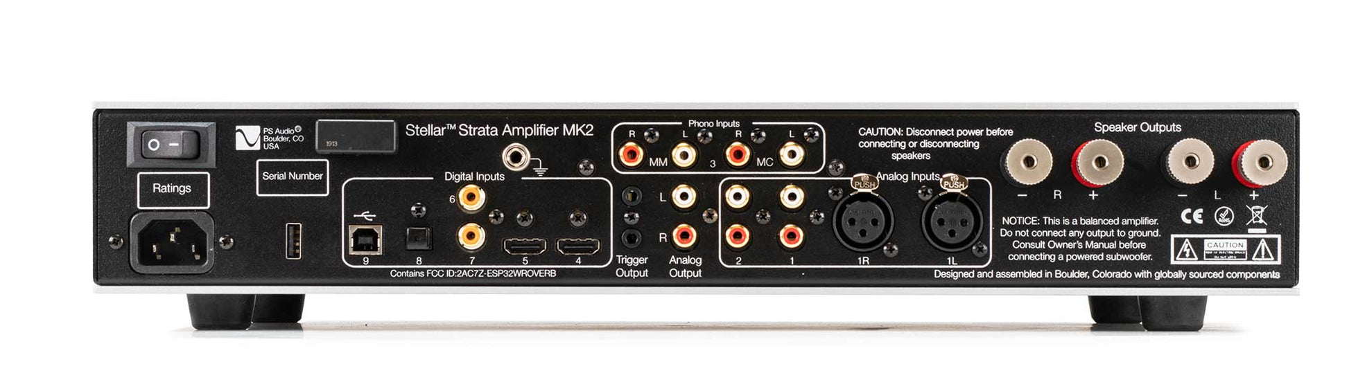

Specifications - Stellar Strata MK2
General
| Color Options | Black Silver |
| Voltage Options | Japan 100V (+/-10%) North America 120V (+/-10%) Europe/Asia 230V (+/-10%) |
| Mains Power Input | IEC C14 |
| Fuses | T250V-250mAH (1/4A Slow Blow) |
| Accessories Included | Remote Control Line Cord: - US, JP and EX (NEMA 5-15P) - Schuko (CEE7/7) (230V version) - UK (BS1363) (230V version) - Australia (230V version) |
| Analog Audio Inputs | RCA: 2 stereo pairs XLR: 1 stereo pair |
| Phono Inputs | MM RCA: 1 stereo pair MC RCA: 1 stereo pair |
| Digital Audio Inputs | I2S: 2 inputs - PCM 44.1KHz to 384Khz, DSD64, DSD128, DSD256 Coax: 2 inputs - PCM 44.1KHz - 192KHz Optical: 1 input - PCM 44.1kHZ - 192KHz USB: 1 input - PCM 44.1kHZ - 384KHz - DSD64, DSD128 (native) - DSD64, DSD128 (DoP) |
| Audio Outputs | RCA (Unbalanced): 1 stereo pair Headphones: 1 1/4" stereo Speakers: 2 binding post pairs |
| Other | Trigger Out: 2 3.5mm, 5-15 DVC USB A: 1 (for firmware update) |
Mechanical
| Unit Dimensions | 17" w x 2.8" h (not including feet) x 13.5" d (with connectors and knobs, chassis only is 12") [43.2cm x 7.1cm x 34.3cm] |
| Weight | 21 lbs [9.5 kg] |
| Shipping Dimensions | 22" w x 8" h x 17" d [55.9cm x 20.3cm x .4.3cm] |
| Shipping Weight | 25 lbs [11.4 kg] |
Environmental
| Location | Indoor use only |
| Storage Temperature | -30 to 70C |
| Operating Temperature | 0 to 45C |
Features
| Input Selection | 9 total: 2 analog, 6 digital, 1 Phono |
| Volume Control | 0-100 (80 dB total range) |
| Balance Control | 12dB each direction in 1/4dB steps |
| Fixed Volume Mode | Analog2: adjustable in setup to any level |
| Phase Control | Digital sources only |
| Filter Control | 3 selectable digital filters (PCM digital sources only) |
| Input Trim | Gain adjustable per input +/-10dB |
| Headphone Trim | Gain adjustable +/-10dB relative to speaker level |
Performance
Analog Inputs
| Input Separation | >85dB |
| Input Impedance | 47KΩ (unbalanced); 100KΩ (balanced) |
| Maximum Input Level | >16 VRMS |
Phono Input
| Cartridge/Type | MM | MC |
| Gain | 40dB | 57dB |
| Loading | 100pF/47kΩ | 470pF/100Ω |
| THD+N | .001% @ 5mV input | .003% @1mV input |
Analog Output
| Output Impedance | Line Out 100Ω |
| Gain | Volume=100 6dB +/- 0.5dB |
Main (Speaker) Out
| Gain (relative to line output) | 30.5dB |
| Output Power | 8Ω, 1KHz, 1% 100W minimum 4Ω, 1KHz, 1% 150W typical |
| Frequency Response | +/-1dB 20Hz – 20KHz -3dB 7Hz – 40KHz |
| THD+N | 1KHz, 10W/4Ω 0.02% |
| IMD | 18/19KHz -65dB |
| Speaker Impedance | 4Ω minimum |
| Output Impedance | 50Hz 150 mΩ typical |
| Damping Factor | 50Hz, 4Ω 29 |
| Sensitivity | @76 1.77 VRMS @100 450 VRMS |
| Channel Separation | 1KHz >90dB |
Headphone Output
| Gain (relative to line output) | 16.5dB |
| Output Power | 300Ω, 1KHz, 1%300mW 16Ω, 1KHz, 1% 3.25W |
| Frequency Response | +/-1dB 7Hz – 40KHz |
| THD | 1KHz, 1 VRMS 300Ω <0.02% 16Ω <0.02% |
| S/N Ratio | 1KHz >110dB (max output) |
| Output Noise | < -90dBV |
| Headphone Impedance | 8Ω minimum |
| Output Impedance | <4 Ω |
Power
| Input Voltage | US 108—132VAC (120VAC nominal) EX/GR/UK/AU 207—253VAC (230VAC nominal) JP 90—110VAC (100VAC nominal) |
| Power Consumption | Idle 20W Typical 50W Maximum 600W |
