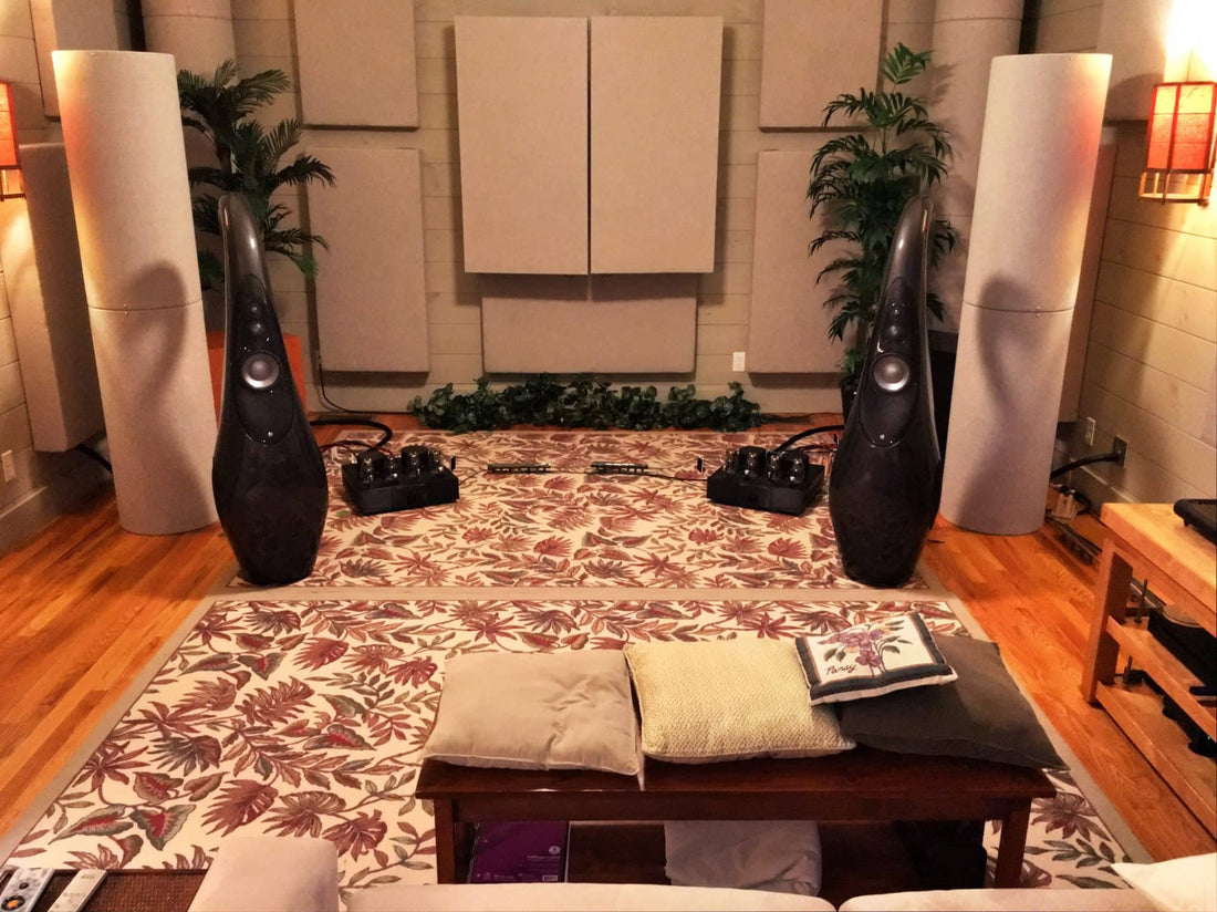

When we moved to our current house, I had the luxury of adding a ‘man-cave’ over the garage we were building.  I did a great deal of research and the result is the room you see in the pics. Its dimensions are 15′ x 21′ x 10′, one of the better ratios for minimizing room modes.  The walls and ceiling are tongue-in-groove pine, floors are oak, doors are solid, all walls are 2″x 6″ studs and fully insulated.  Floor joists were also doubled in a couple places for rigidity.  Electrically, there are 4 dedicated circuits – one on each side wall for power amps, and one each for analog and one for digital.  All, of course, on the same leg from the sub-station box in the garage.  I’ve been fortunate in that this design is absolutely quiet.  I use PS Audio receptacles on these circuits.
As part of this move, a few more upgrades were made.  I added a second BAT amp, and bridged the two for mono.  I also purchased a fully ModWright-modded Oppo 95 universal player.  This player, using 6sn7 tubes, sounded very good—it’s gone now— and became even better when used with the NOS Russian 1578 (the real deal) tubes.  Additionally, I added 2 REL B1 subs and a BAT VK52se preamp. A 10-meter Audio Tekne ARC500 is the sole interconnect cable in the system.
At this point, Copper columnist  Jim Smith came to set up my system to fullest advantage, and he made this system sound even better.  Jim also recommend the addition of Tube Traps in the corners and behind the speakers, and I made homemade traps for the first reflection points.

The rack in the pics is my homemade version of the Arcici suspense rack.  The top shelf is suspended on tennis balls, and the lower shelves are suspended below it.  On top are the MSB DAC and power supply.  Middle shelf holds the Oppo player and DirecTV box.  On the bottom are the NAS, and isolation box for the MSB, an HDPlex power supply for the NAS, and a switch for the ‘final inch’ component.  I also use an optical network converter just prior to the DAC to get any noise out of the digital feed.
The Vivid G2 Giya speakers are the last addition. They are wired to the mono amps with doubled Cardas 9.5 gauge Litz for the bass and a Synergistic Research Tesla cable for the highs.  These bring this system to a level that is as good as I have heard anywhere.  I have largely remained true to Jim’s setup, with some minor changes to accommodate the Vivids, of course.  I listened to Wilsons and Magicos also, but the Vivids were a pretty easy choice.  To me, they have a more ‘alive’ sound and wonderful imaging, and they don’t weight a ton like the other high end choices.  Their thorough engineering is very impressive visually and sonically.  Even my wife loves them!
