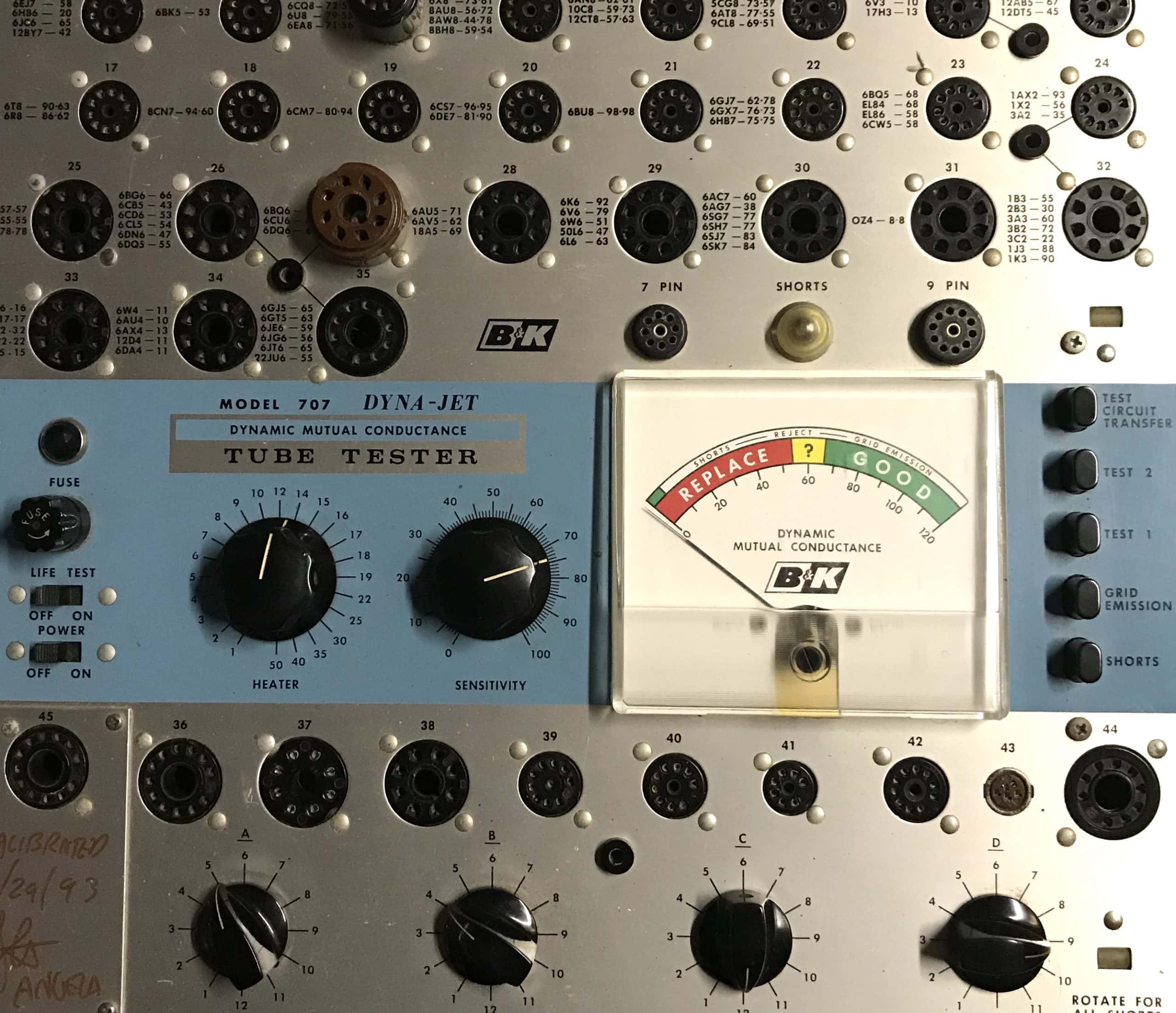

The most popular tube tester in history was the TV-7 Series, which was made for the US military by Hickok and others. At one time these testers could be picked up at the second-hand market for very little money, but they themselves use tubes and need to be restored and calibrated in order to perform correctly. Audio clubs with sufficient funds and expertise should invest in a laboratory-grade tube tester for their members’ use. The best vintage examples of these include the British AVO VCM 163 and the German Neuberger RMP370. My recording partner bought two AVO163s and used one as a parts donor to restore the other. The tester is a great piece of British engineering, and a real pleasure to use. Vintage tube testers were also made by B&K, Eico, Knight, Precision Apparatus Company, Sencore, Heathkit and others.
[Copper’s J.I. Agnew refurbishes tube testers. He’s located in Europe. Vintage Tube Electronics is located in the US and repairs and calibrates tube testers. – Ed.]
