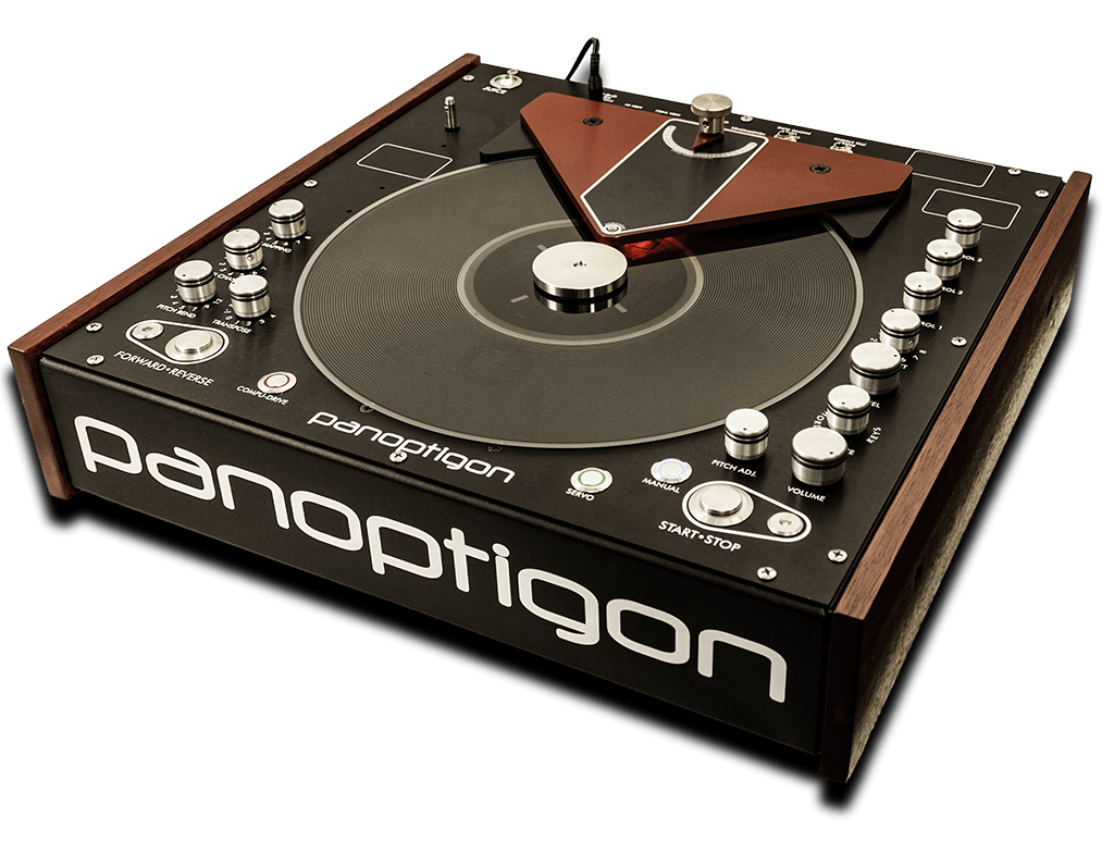

JS: I’m going to switch gears to talk about Quilter’s Panoptigon disc player, something Copper readers might find particularly interesting. The Panoptigon plays proprietary optical discs like the type originally made for the 1970s Mattel Optigan. The Optigan was a keyboard instrument that played pre-recorded sounds stored on these discs in a similar manner as the more well-known 1970s Vako Orchestron (or the Mellotron, which played sounds stored on strips of magnetic tape). Why did you decide to offer this unusual product?
The Panoptigon.
PQ: Robert Becker was my project manager at QSC and has become a vital part of the team at Quilter Labs. Some years ago he was looking at a hanging mobile that emitted a light display, and remembered seeing something like that online. He discovered that it was a British system developed in the 1920s to automatically tell you the time when you dialed up the phone number. It had rotating glass discs with [recorded voices for each digit] on them.
That led him to a fellow named Pea Hicks, who had created a website celebrating the Mattel Optigan, [which] everyone had more or less forgotten about. Of course, we all know Mattel as a toy company, but they apparently had ambitions to get into a higher-price-point adult toy range by making home organs.
Now, the home organs of the 1960s came in two classes. You had cheesy little reed organs with chord buttons, or you had elaborate electronic organs such as the Hammond or Gulbransen, which cost thousands of dollars, were as heavy as a piano, and were serious instruments that also required keyboard skills to play them.
So, somebody at Mattel came up with the idea: if we recorded rhythm tracks instead of just having chord buttons, you could sound like an orchestra playing while picking out the melody on a small keyboard. And we can then sell various styles of music on discs plus E-Z Play songbooks. They’d set these Optigans up outside the organ store at the neighborhood mall and collar people. “Look! You can be a musician! Hold this button down!” – and you’d hear, “shung-a-lunga-lunga” (rhythm sound). “Now play these notes! Two fingers and you’re playing a song!”
They sold these things for $600. They had a surge of popularity and planned to release an endless stream of new discs so the thing wouldn’t go stale, but – the machines just weren’t very well made. The discs, made out of clear film. began to slip; wouldn’t stay in tune and if you didn’t take care of them they’d get scratchy pretty quick. So after a couple of years, the Optigans all wound up in the closet.
Forty years later, Pea Hicks becomes fascinated by this history, digs up some interesting material, and manages to contact one of the remaining engineers who had worked on the project. The engineer had kept a carton full of memorabilia about the Optigan, including never-issued master tapes! So Pea got his hands on all this stuff and started featuring [it] on his website.
Robert stumbled across this and chatted Pea up on what was going on. Pea mentions, “My Optigan needs restoration. You’re in electronics, aren’t you? Could you do something with it?” So Robert winds up restoring several Optigans. It was a frustrating job. The electronics and transport were primitive and even with great effort, never really worked that well.
Robert ended up saying, “I could make a better one from scratch.” Long story short, he came up with our Panoptigon. It uses a servo-controlled drive so you can set it to discrete pitches. It has the ability to start and stop from [a MIDI-linked] keyboard, you can [play the discs] backwards, [change the pitch]…and many other user-friendly features [and improvements].
After the Optigan came and went, another company, Vako, issued the Orchestron, which used the same disc format, without the rhythm tracks. The Orchestron [was designed to] to compete with the Mellotron, which used little strips of tape that gave you the actual notes, but could only play for eight seconds before the tape had to rewind. You can imagine how finicky a machine like that would be. The Orchestron was somewhat better built, [and] more capable of being hauled around on tour. But they too gradually went under. Digital synthesizers and sampling keyboards put all these guys out of business.
So now we come to the present day, where the optical discs have become kind of an art form in themselves. They do have a distinctive tone quality, and the limitations of the format, with everything in two-second loops, can actually lead to artistically interesting results. You can experiment with recursion and create interesting rhythm patterns.
Pea had mentioned he had all of these unissued tapes and lamented, “It’s too bad no one’s ever going to be able to record new discs.” Robert thought, “I can think of a way to do this on a computer with a .WAV file and an art program” [without using an optical recording head]. So by using modern resources, he can actually master optical discs from scratch. [As a result] Pea has been able to release some never-before-issued disc Mattel [would have issued but never did], as well as create new ones.
They’re having a lot of fun with it, and…it’s of my unspoken missions for Quilter Labs to do cool things that you couldn’t justify on a business level, but that somebody ought to do. So this was one of our opportunities to bring something to market that may have a small band of aficionados who appreciate what we’ve done. It’s an interesting, creative piece of work [and] I don’t know where else you might have gotten something like that to happen.
The Panoptigon.
