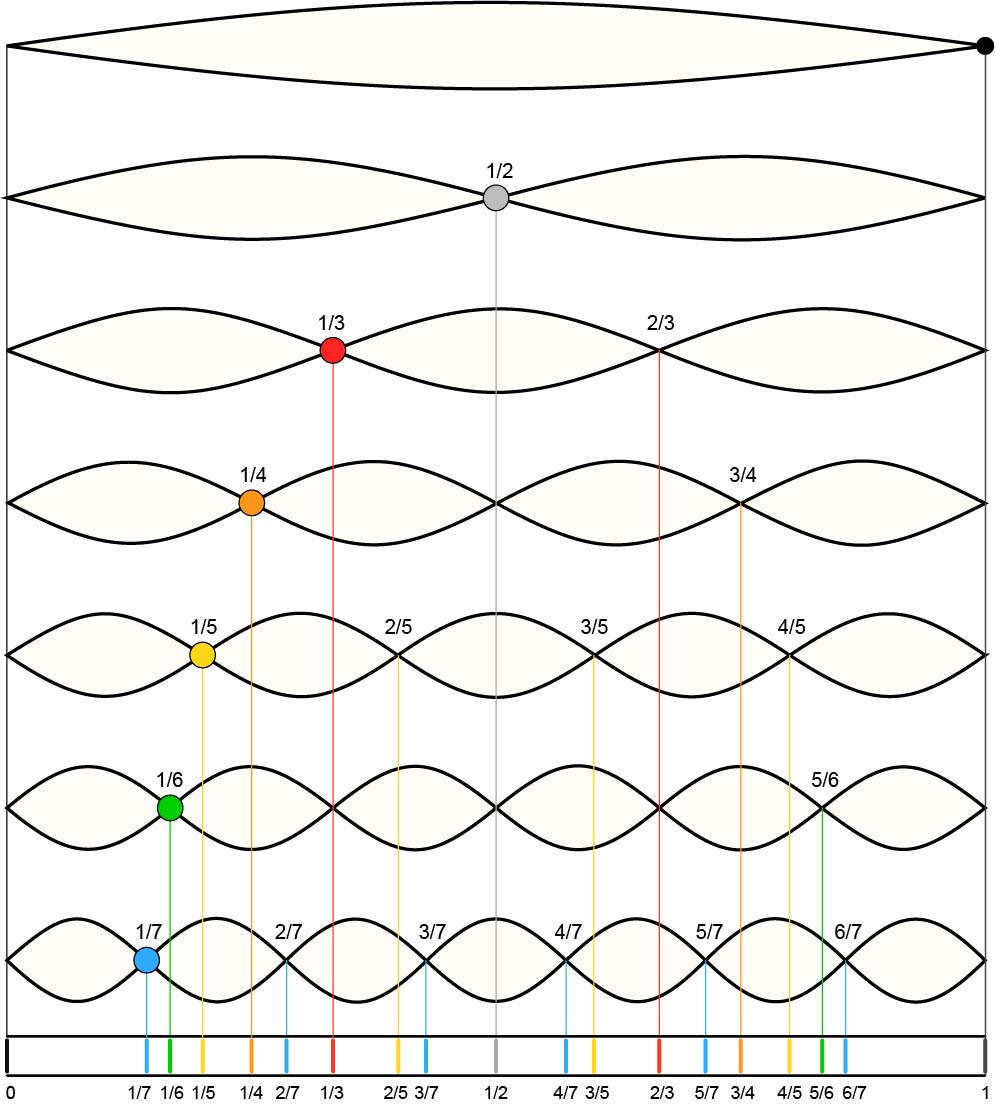

When we think about distortion products we are generally referring to the harmonic kind. Harmonics are naturally occurring byproducts of sound: a plucked string will generate the intended frequency (called the first harmonic) and then higher versions of that note, each slightly less loud than its predecessor. These higher frequencies are all integers (whole numbers) of the note. For example, if the note is 50Hz, the first three higher harmonics are (times 2) 100 Hz (2nd harmonic), (times 3) 150 Hz (3rd harmonic), (times 4) 200 Hz (4th harmonic).
