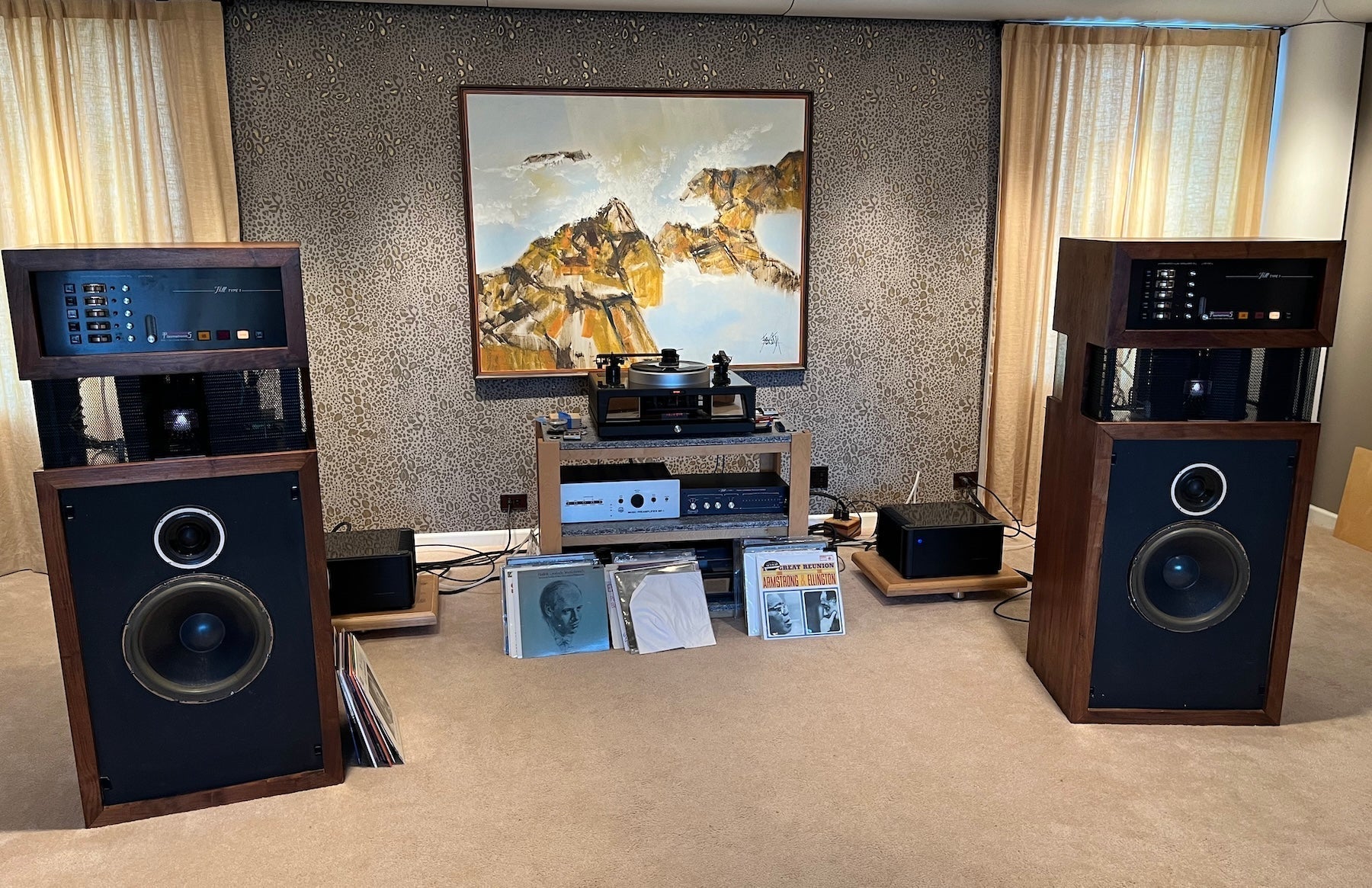

The speakers are big and imposing, and, well, most people would consider them ugly if not downright hideous, with their box shape, 1970s wood finish, clunky control panel at the top, and industrial-looking middle section that houses the plasma tweeter, something that seems to have been designed with 100 percent consideration to functionality and zero to aesthetic appeal. Although looking at the plasma flame itself is fascinating. There’s something primeval and alluring about it, aside from the fact that such a device can actually make music. (For more information on the speaker, click on this Stereophile review originally written by J. Gordon Holt in 1980 and republished in 2014, which was an invaluable resource in researching this article.)
Beauty is in the ear of the behearer: one of Brian Walsh's Hill Plasmatronics speakers.

Header image: the Hill Plasmatronics speakers in Brian Walsh's listening room. All images courtesy of Brian Walsh and the author.
