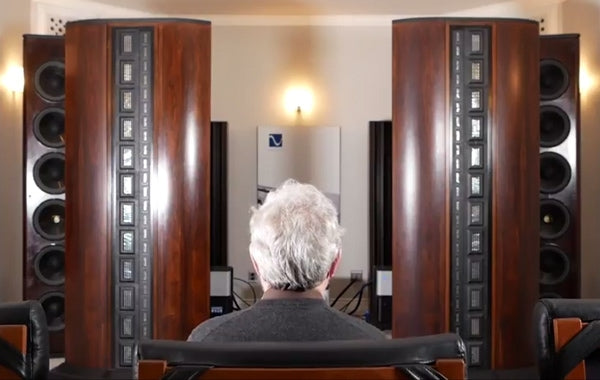

Recent visitors to Music Room 2 may have noticed a rattling noise in the left channel of the IRSV system on bass notes. The 35-year-old woofers in the Infinity IRSV are struggling. Sad, but true.
This system is our lifeblood reference. It's one of the most revealing loudspeakers I have ever had the pleasure of using, and while not perfect (let me know if you find a perfect loudspeaker), it represents our consistent benchmark by which we can judge designs.
Time for an upgrade to the bass system with a more modern approach. As much as I might want to preserve the IRS in its original state, I recognize it's not a museum piece.
Our senior speaker engineer, Chris Brunhaver, pulled all 12 of the IRSV's original woofers out and replaced them with a more modern, beefier, lower distortion, higher excursion, version. Once out of their box, I was reminded of just how old, tired, and lacking the original woofers are: cheap stamped frames, small magnets, short coils, conventional spiders and surrounds. The only exotic element was their graphite cones. Back in the day, they were "the bomb". Over the years much has changed.
