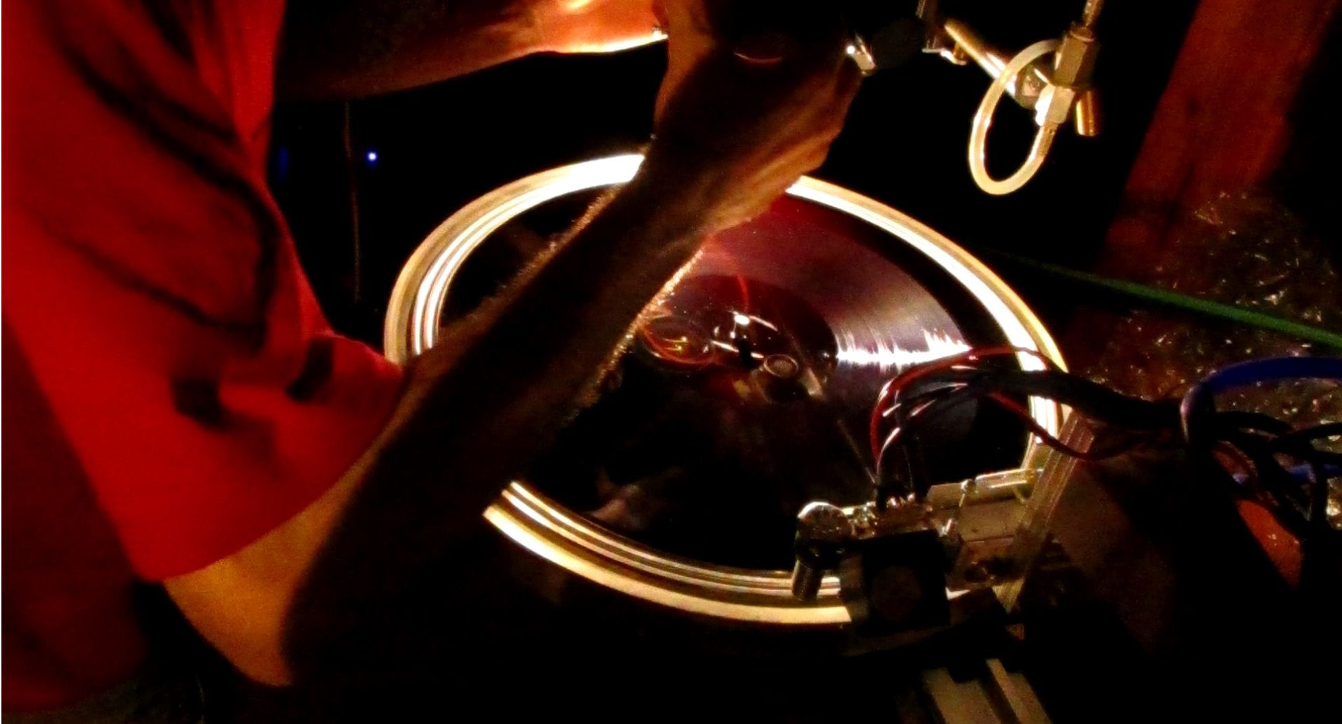

The author, inspecting a master cut on a heavily-modified 1940 Neumann-based system.
