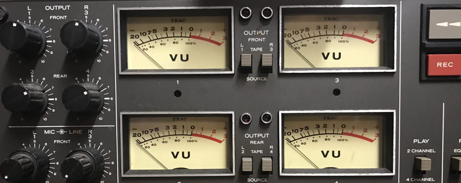

This is no longer about loudness, but about impact, transients and dynamics. This is one of the biggest secrets to realistic sound reproduction. The commonly achievable dynamic range of the vinyl record already far exceeds what can be heard in a typical domestic listening room and even challenges professional studio systems. We could even cut a wider dynamic range than that on a record, but very few playback cartridges would be able to reproduce it.
VU meters on a Teac A-3340S four-track tape recorder.
For decades, as a direct consequence of the loudness wars, a lot of technological development in disk mastering systems was concerned with increasing the apparent loudness. Yet, the ability to capture the sharp transients (instantaneous loudness), which depends more on the skill of the engineer, was there all along! Which beautifully explains why many audiophile records, known for their excellent sound, were cut using very early, bare-basics, manually operated disk mastering lathes.
