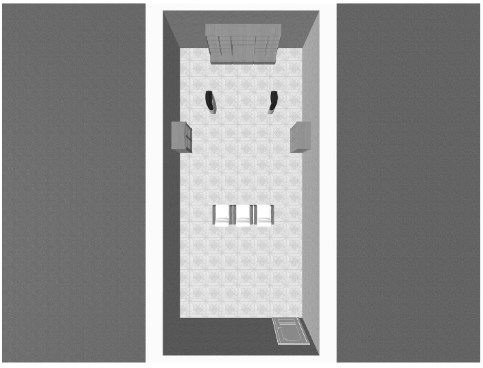

Points of first reflection.
Now that we’ve created our acoustic map and have a good sense of our room’s personality, it’s time to tackle one of the most critical aspects of room setup: identifying the points of first reflection. These points can make or break your stereo imaging and soundstage depth, and finding them is actually quite simple, though you might feel a bit silly doing it.
Let me introduce you to what we call the “mirror trick.” It’s been around since the early days of stereo, and despite all our modern measurement tools, it remains one of the most effective techniques in our acoustic toolbox. You’ll need a small mirror (a hand mirror works perfectly) and either a friend to help or a good pair of knee pads (trust me on this one).
The Point of First Reflection
Have your friend slide the mirror slowly along the side wall, keeping it flat against the wall at the approximate height of your speakers’ tweeters. You sit in your marked listening position and watch the wall. At some point, you’ll see the reflection of your left speaker appear in the mirror. Bingo! Mark this spot with your blue tape this is your first reflection point for the left speaker on the right wall. Do the same for the other speaker on the opposite wall. But we’re not done yet. You’ll want to repeat this process on the floor (this is where those knee pads come in handy if you’re working alone). And don’t forget to check the front wall behind the speakers for reflections that might bounce back to your listening position.
Why are these points so important? Think of them as acoustic mirrors bouncing sound directly to your ears, arriving just milliseconds after the direct sound from your speakers. These reflected sounds can either enhance or destroy the stereo image your speakers are trying to create. When the reflected sound arrives within about 20 milliseconds of the direct sound, your brain processes it as part of the original signal. Any later, and you start to perceive it as a distinct echo.
Here’s an interesting historical note: This understanding of first re!ections’ importance emerged from research done in the late 1960s by Dr. Helmut Haas, expanding on earlier work about the precedence effect. The high-end audio community, particularly through the writings of Roy Allison and later Peter Walker of Quad, began incorporating these findings into room setup techniques in the 1970s.
You might be surprised to find that these reflection points aren’t exactly where you expected them to be. That’s perfectly normal. Room geometry can create some unexpected paths for sound to travel. I’ve set up systems in hundreds of rooms over the years, and these reflection points still occasionally surprise me with their locations. For now, just mark these points; we’ll address treatment options later. What’s important is that we’ve identified them. Think of these points as acoustic hot spots that we’ll need to manage. They’re not necessarily bad in fact, some designers argue that controlled first reflections can enhance the listening experience. But knowing where they are gives us power over how they affect our sound.

Now that we’ve identified those critical first reflection points, it’s time to do something about them. In my new listening room at PS Audio, I’ve chosen to use eight-foot-tall wooden diffusers at these points, and there’s a good reason for this choice. While absorption panels are more commonly recommended (and can work well), I’ve found that properly designed diffusers can maintain the room’s sense of life and space while controlling potentially problematic reflections.
Bookcases make great diffusers.
But not everyone wants their living room to look like a recording studio. One of the most aesthetically pleasing and effective solutions I’ve encountered over the years is the strategic placement of bookcases. A well-filled bookcase can be an amazingly effective diffuser, and there’s solid acoustic science behind why this works. Books of varying sizes, arranged on shelves, create an irregular surface that breaks up sound waves in much the same way as purpose-built diffusers. The different depths, heights, and densities of books create a naturally random pattern that scatters sound energy rather than reflecting it coherently. Plus, the spaces between and behind the books act as mini-absorbers, providing a nice balance of diffusion and absorption.
I’ve seen some beautiful listening rooms where floor-to-ceiling bookcases line the side walls at the reflection points. The key is to fill them somewhat randomly don’t organize your books by size or create too uniform a pattern. Nature abhors straight lines, and so does good acoustics. Mix up hardcovers and paperbacks, add some decorative objects of different materials and shapes, perhaps even leave some spaces partially open. The more random the arrangement, the better the diffusion.
Behind the speakers, bookcases can be particularly effective. Not only do they help control those problematic back-wall re!ections, but they can also create an attractive focal point for the room. I’ve seen setups where a central equipment cabinet is flanked by bookcases, creating both an acoustic treatment and a natural entertainment center. The beauty of using bookcases is that they serve multiple purposes: they’re functional storage, they add visual warmth to the room, and they provide excellent acoustic treatment. Your significant other might be more amenable to bookcases than black acoustic panels, and your books finally have a purpose beyond collecting dust.
If you’re considering this approach, aim for shelves that are at least 12 inches deep this gives you enough space for larger books and creates more effective diffusion. Avoid glass doors on the bookcases; you want the sound waves to interact directly with the books and shelves. And don’t worry too much about perfectly symmetrical arrangements some randomness in the book placement actually helps with diffusion. Remember, whether you’re using purpose-built diffusers or bookcases, the goal is the same: to create a lively but controlled acoustic environment that enhances rather than detracts from your listening experience.
Think of diffusers as acoustic prisms. Instead of absorbing sound energy or reflecting it like a mirror, they scatter it in multiple directions, breaking up the coherent reflected wave that could interfere with our stereo image. This scattering effect helps maintain the room’s natural ambiance while preventing the focused reflections that can smear imaging and detail. The height of these diffusers is intentional. By extending them well above and below the speaker and listening heights, we’re managing reflections across a broader range of listening positions. You might not always sit perfectly still in your sweet spot, and these tall diffusers ensure good performance even as you move around a bit.
But let’s talk about that front wall, i.e. the one behind your speakers. This is where I typically add more diffusers, and there’s some interesting acoustical science behind this decision. When sound waves emerge from your speakers, they don’t just travel forward toward you; they also radiate backward. These back waves hit the front wall and can reflect back into the room, arriving at your ears significantly later than the direct sound. This delayed energy can blur detail and compress the sense of depth in your soundstage. By placing diffusers behind the speakers, we’re not trying to eliminate these reflections entirely (that’s what makes some heavily damped rooms sound dead and uninvolving). Instead, we’re scattering these reflections in a way that creates a more natural sense of space. It’s similar to how concert halls use diffusive surfaces to create a sense of envelopment without destroying clarity.
Diffusers or another bookshelf front wall.
I learned the importance of front wall treatment years ago when setting up systems in dozens of different rooms. Rooms with bare front walls often produced a somewhat flat, two-dimensional sound stage. Add proper diffusion behind the speakers, and suddenly the sound stage could extend well behind the speaker plane, creating that “looking through a window into the performance” effect that we all chase. The key is balance. Too much diffusion can make the room sound artificial or confused, while too little leaves us with those problematic focused reflections. In my room, I’ve found that covering about 40 percent of the front wall with diffusers provides the right balance between control and natural room sound.
As you position your diffusers, remember that they don’t need to be perfectly symmetrical (though the ones at the first re!ection points should be). The goal behind the speakers is controlled randomness, much like what you’d find in a well-designed concert hall. Some audiophiles even stagger their front wall diffusers at different distances from the wall to create additional randomization of reflections.
