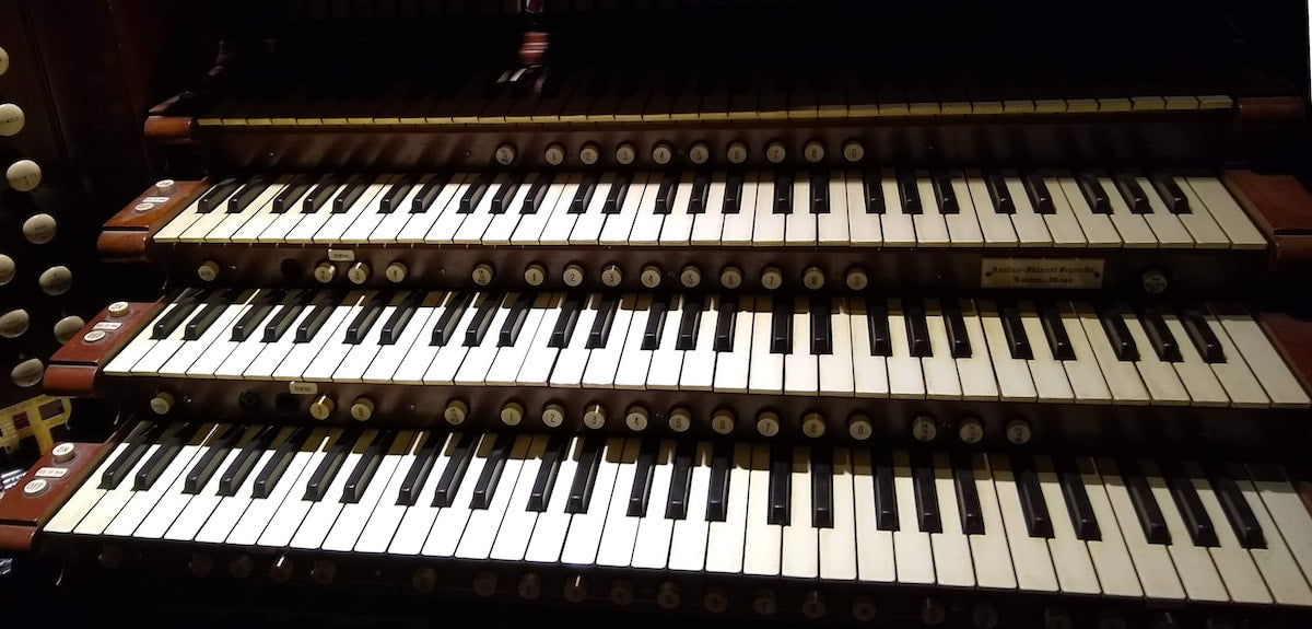

Copper Issue 61 covered the innovative workarounds devised by Kamel, which included solutions for mechanical keyboard latencies, damaged pipes, non-working stops, and temperature sensitive pipe tuning fluctuations. Never satisfied in his quest, Kamel has continued refining the process, with the ultimate goal being able to have a full orchestra in combination with the ancient pipe organ at his fingertip command. The changes he has made since Copper Issue 61 cover both digital and analog modifications and improvements. Creating an Actual/Virtual Cyborg Hybrid Organ: The three most glaring playing challenges with Calvary’s Aeolian-Skinner organ are:
  • Latency of varying milliseconds across all four of the keyboard manuals, making any kind of staccato playing virtually impossible;
  • Temperature sensitivity of the metal pipes within the 200-year-old stone and wood church. The pipes can vary individually from A440 standard concert pitch anywhere from A427 to A442.
  • Access to stops that were inoperable to blend with the ones that were still in use.
Taking advantage of the inherent natural acoustic delay and reverberation from Calvary’s 40-foot-high steeple and with the organ pipes mounted 20 feet above the pews along the altar perimeter and in the church's rear near the entrance, Kamel had previously solved the problem by using the organ’s circa 1980s Peterson MIDI interface, which is limited solely to MIDI out on Channel 1 and only transmits note on/off data. The deployment of the Hauptwerk Virtual Pipe Organ and its Notre Dame de Metz sample was Kamel’s initial solution, as the virtual organ had no latency and could thus provide the attack for the notes as the Skinner organ’s tones fleshed out the body of the notes. The Hauptwerk software also resolved the tuning fluctuation problems as the precise digital tuning could adjust to match the pipes for any particular climate condition. The software’s high cost (about $1,000) also is due to its unique capability to drive the actual organ pipes via MIDI. Finally, the software provided the missing Gallery, Great and Choir manuals/stop colors that the Skinner organ could not produce in its current state of disrepair.

While Kamel had solved the most pressing mechanical issues, the Notre Dame sample was recorded in a space considerably larger than that of Calvary Church. Additionally, Notre Dame’s organ is a much more elaborately-featured instrument than the Aeolian-Skinner. Choosing uniformity and authenticity of sound over a more luxurious, albeit less than ideal accommodation, Kamel has since opted to switch the Hauptwerk software license to the CCARB, which is a sample of the pristine Aeolian-Skinner Opus 1141 pipe organ recorded at Christ Church Cathedral Arboretum in Garden Grove, CA. Better matching between the virtual and actual Aeolian-Skinner organ sounds and controls was the first goal in Kamel’s plan to bring the Calvary organ back to fully functional status. Even if it was a “cyborg” hybrid, Kamel’s desire was to next incorporate the bass pedal sounds and other stops, along with other MIDI controlled sounds. Kamel’s four-keyboard manual signal chain first runs from the Calvary Skinner organ, locked to a MIDI clock while the MIDI out is split between a Hewlett-Packard 2420 PC running Hauptwerk’s CCARB, and a MacBook running Spitfire Audio Eric Whitacre choir, Symphonic Strings, Hans Zimmer percussion and Logic Pro X software. His display monitors are all touch sensitive.
Where it all comes together.
These MIDI signals are connected through a Korg Nanocontrol Studio MIDI controller and an Akai APC40 Ableton controller. As Calvary’s Skinner organ bass pedal foot pistons were never retrofitted with MIDI capability, he has added a Behringer FCB 1010 MIDI controller (with custom mounting frame designed by church elder Jeremy Coleman) and a Studiologic MP113 velocity-sensitive bass pedal unit. The Behringer controller’s MIDI signal is separately fed to a Focusrite Scarlett interface and then to the CCARB software. With Calvary’s Swell manual only 25% functional and the Gallery, Great and Choir manuals even less so, the CCARB software is crucial at the note origination level for fleshing out the missing overtones and recreating vital fundamental tones in the organ music repertoire. Additionally, while all the basic Skinner stops in Calvary’s organ still function, Kamel cannot add any additional colors to the sound due to the pipe disrepair, so the CCARB is crucial for supplying 32-foot, 16-foot, 8-foot and 4-foot octave tones as needed.

To quickly switch between Logic commands and the variety of presets that may be utilized between the various Spitfire orchestral and choir sounds, Kamel has a pair of mini keyboards mounted above the organ manuals: an Akai LPK 25 and an iRig keys. A 61 full-sized-key Korg synthesizer sits next to Kamel’s personal Yamaha concert grand piano, which acts as a backup MIDI controller in the event that the Calvary organ suffers a mechanical or electronic mishap.
