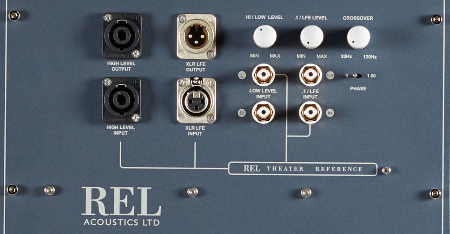

Which is why so many subs have what's called an LFE input (Low Frequency Effects). Basically, the LFE is a direct shot into the subwoofer's amplifier without going through its crossover. Thus, the crossover in the receiver or SSP controls how high the bass goes and to what degree its roll off should be tailored to.
Here's a simple rule of thumb. In a two-channel setup, you will always use the subwoofer's built-in crossover.
In a home theater setting, it can vary: if connecting through the subwoofer's high-level inputs use the sub's internal crossover. If connecting the SSP via RCA use the subwoofer's LFE input.
