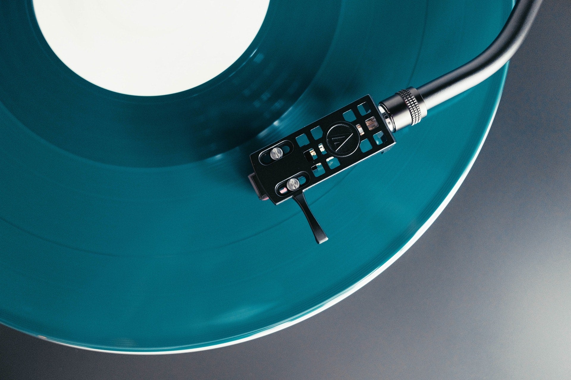

That's not true when it comes to a device such as a phono cartridge. Here the small coil generating the voltage feeding the phono preamplifier is part of what we refer to as a tank circuit—a tuned inductive network where the frequency response is a function of impedance and capacitance.
Think of it like a filter where the resulting output is dependent on the values of the elements that make up the network: coil, cap, resistor.
