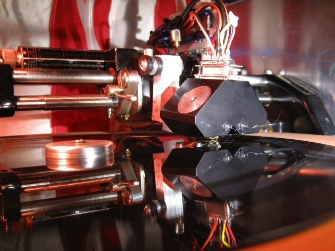

The most reliable method of verifying absolute polarity on a disk reproduction system is to reproduce a suitable test record of known polarity and observe the output of the preamplifier on an oscilloscope. The test record must of course include a band containing an asymmetric waveform, intended for absolute polarity verification. The correct polarity of the oscilloscope itself can be verified with a simple battery. Some preamplifiers might not be preserving polarity between input and output, in which case you will need to reverse the wiring on your cartridge to compensate. Cartridge wiring color coding is also covered in the standards [10]. In all cases, where the output of your preamplifier appears to be of the wrong polarity, a simple reversal of the + and – wires on both channels of your cartridge will provide instant relief!
Polarity Considerations for Disk Recording Equipment
Those of you who cut records can verify the polarity of your cutting system by cutting a suitable asymmetric waveform and checking it under the microscope, or reproducing the cut on a verified reproduction system. Keep in mind that if both the cutting system and reproduction system are inverting, the polarity will appear to be correct, due to the preservation of the error (by “flipping” the waveform twice) and hence the “relative polarity” . This is not an indication of correct absolute polarity however.
Be careful when trying to cut an asymmetric square wave (or any squarish wave at all), as it contains harmonics extending to very high frequencies. You run a serious risk of frying your cutterhead. You could also cut a half-wave rectified sine wave instead, as recommended by Paul Gold [20] and Peter Butt [21],  or an asymmetric sawtooth wave as recommended by Vanderkooy/Lipshitz [22].
The articles by Butt [21] and Vanderkooy/Lipshitz [22]  refer to methods of verifying the absolute polarity of magnetic tape recorders (and are in conflict with each other regarding the direction of magnetization), but the same principles and test signals can be applied to disk records.
In any case, proceed with caution. All of the aforementioned waveforms contain a lot of harmonics and will demand considerably more current while cutting a disk, compared to a normal sine wave. If your cutting system is not correctly set up, such signals could excite resonances that cause self-oscillation, which means expensive damage! All such testing shall be done entirely at your own risk. You have been warned!
Some Neumann amplifier racks are known to invert polarity. The FloKaSon Caruso preamplifier is inverting polarity. If the cutting amplifier is also inverting and the head is correctly wired, the result will be correct. The Agnew Analog Reference Instrument Type 891 cutting amplifier [27], which I have developed, preserves  polarity, so if used with the Caruso preamplifier and a correctly wired cutterhead, for example, the result would be inverted. To avoid that, you can invert the wiring to the cutterhead (both drive coils and feedback coils on both channels). The result will then be in accordance with the standards. On the other hand, the Agnew Analog Reference Instrument Type 710 disk recording pre-emphasis module preserves polarity as well, so if used with the Type 891 or any other cutting amplifier which preserves polarity, the wiring to the cutterhead shall be configured in the standard manner to preserve polarity on the resulting disk.
If you are monitoring the feedback signal, keep in mind that this is meant to be inverted at some point, relative to the cutting amplifier output signal, it is negative feedback! On the Caruso preamp, the output to the cutting amplifier is inverted relative to the input, and the feedback monitor signal is of opposite polarity to the output. Therefore, the signal at the feedback monitor output should be of the same polarity as the program material input, provided that the cutterhead is correctly wired and labeled. The correct wiring of the cutterhead depends on whether the cutting amplifier is inverting or not.
Each make and model of cutting electronics is designed differently, so you will need to do some figuring out of how the equipment is configured when putting together a disk mastering system.
Also keep in mind that your microscope might be inverting the image it displays and that on most lathes the microscope is located at the opposite side of the disk. You need to imagine how the reproducing cartridge will respond to the groove modulation you are seeing and if you are looking  at a (possibly inverted) image from the opposite side to where a tonearm is usually located, thing can get confusing. Once you manage to orient yourself, it should be easy to confirm the polarity visually.
