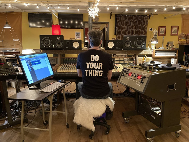

Header image: Chris Mara of Mara Machines.
