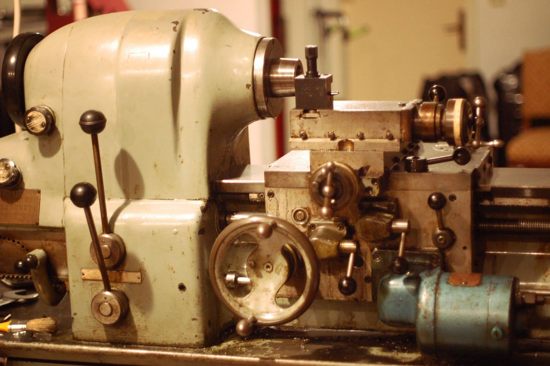

The apron of the Hardinge HLV lathe, with longitudinal feed wheel, cross-feed ball-crank handle, power feed motor, feed clutch levers, half-nut engine lever, carriage lock lever and sight glass for maintaining the oil level.
