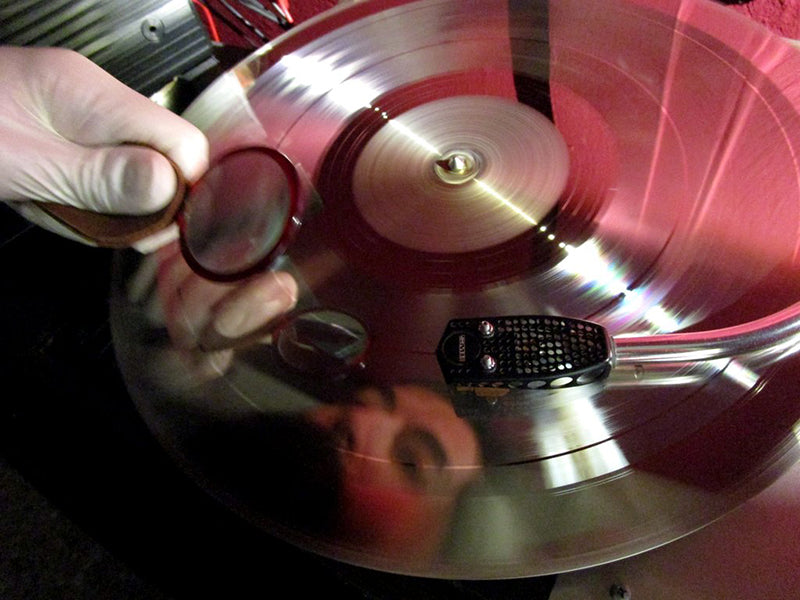

Header image:  J.I. Agnew reflected on a metal mother, played back on a turntable with a Shure V15III cartridge on an SME tonearm. Courtesy of Agnew Analog Reference Instruments.
