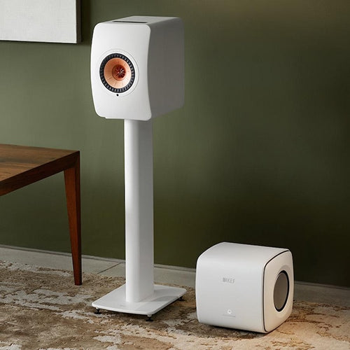

Header image: KEF KC62 subwoofer and LS50 Wireless II speakers.
