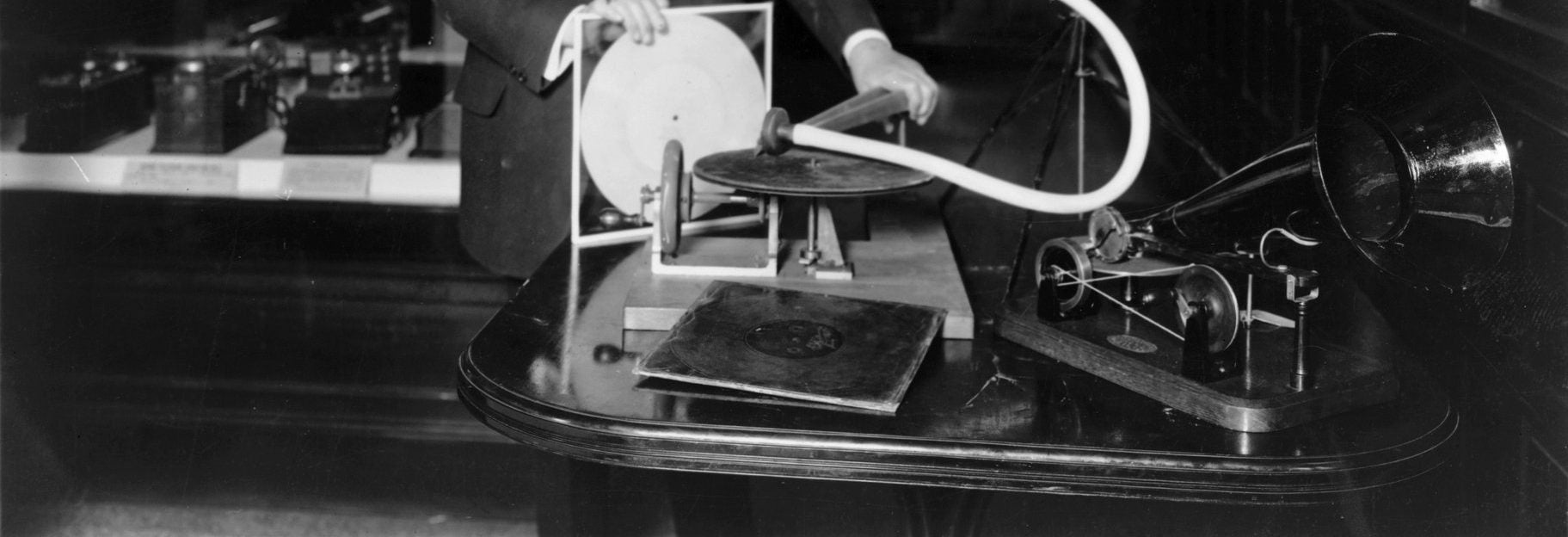

German-American engineer Emile Berliner (1851-1929) with the model of the first phonograph machine which he invented.
