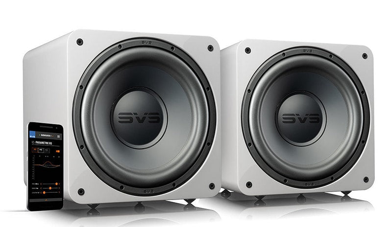

Header image: SVS SB-1000 Pro subwoofers, available for purchase as a package of two.

Another advantage of multiple subs is that you can use subwoofers with smaller drivers (and a smaller form factor), which can successfully quash the room modes while still maintaining great bass dynamics and punch, without the need for huge subwoofers in your room. Be aware, though, that that there is a tradeoff between output and smoothness. Using two to four subwoofers throughout the room will give you a smoother low-frequency response, but with a similar output level to employing just a single corner-loaded subwoofer.
