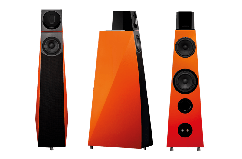

Header image: Kaiser Acoustics Kawero Vivace loudspeakers. From the Kaiser Acoustics website.
