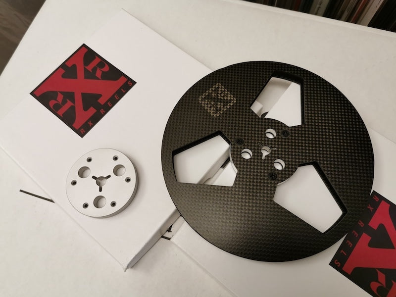

He arrived with two prototype spools and a hub on its own, and the workmanship was as fine as anything I have seen in machined metal. And cynics please note: the RX spools are made entirely in the US. Even the carbon fiber has a tale to tell: it is truly aviation-grade, as well as enjoying green credentials because Root has found a source for offcuts from an airplane manufacturer, so recycling is part of the process.
The machined hub.
The machined hub.

Unfortunately, I threw him a curveball when I pointed out that decks of a certain vintage – including my cherished Denon DH-710F – employed a locating peg that requires a hole that is approximately 1/2-inch from the primary spindle. This is not necessary with the NAB hubs of the 10-inch spools because every NAB hub adaptor I’ve seen has the requisite aperture on its back to accept a locating peg.
This is accounted for, too, on every plastic spool I have ever seen, usually with a series of equidistant holes, or the positioning of the aperture for the tape threading. Kevin opted instead, in order to maintain ultimate balance, to design a hub with three equidistant holes.
The machined hub.
The machined hub.
