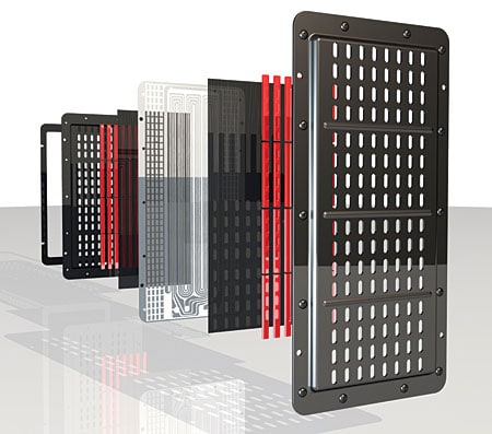

I worked as an engineer at Bohlender Graebener starting at the age of 26, for five years from 2005 – 2010. Although the company had developed newer, lighter and more efficient versions, through the use of photo-etched diaphragms and rare earth magnets, BG was also still using the same assembly jigs that my father and David had developed for Speakerlab that had been used to build the 20-foot tweeter. The assembly jigs had continued to be used to produce those older line source models until 2013, when the company was acquired by Christie Digital in order to use the technology as the underpinnings of their cinema speaker line. I now work as the senior speaker design engineer at PS Audio. We’re currently working on a new speaker, the FR-30, as the first of an entire high-end loudspeaker line utilizing our using custom planar magnetic driver technology at its core. That big ol’ tweeter has an even bigger place in my heart, and is much of the reason that I’m where I am today.
Exploded diagram of a Bohlender Graebener NEO10 driver, a descendant of the 20-Foot Tweeter.
