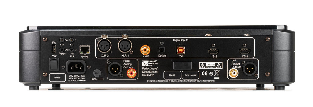

Digital audio inputs
I2S (2), Coax, XLR Balanced (2), Optical, USB

Analog Audio Output
Connector RCA single ended or balanced, XLR balanced
