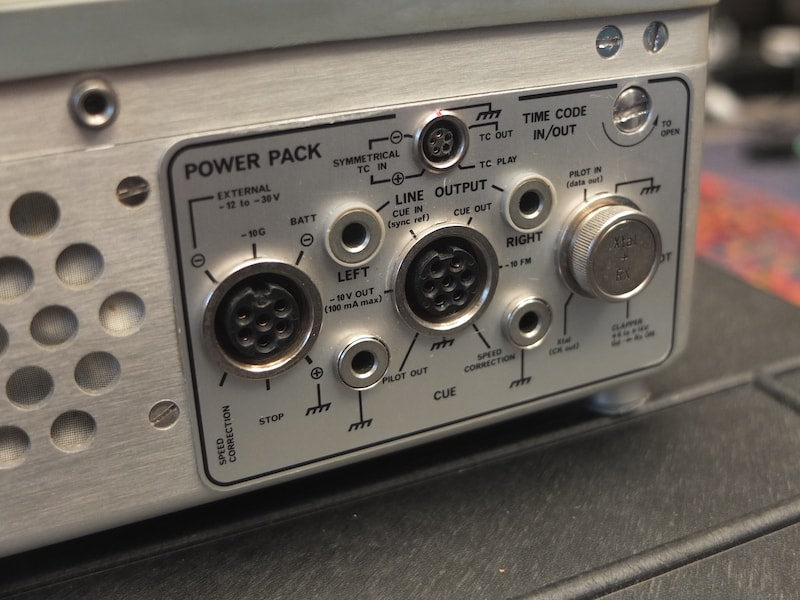

A fellow enthusiast and Nagra IV-S owner in the UK, an inveterate scourer of the internet for tape-related tidbits, noted some time ago that a dedicated cable had been produced by Transparent Audio for the Nagra IV-S at Nagra’s behest. At first, I scratched my head, wondering what could be squeezed into the 7-pin Tuchel connector used for the deck’s line-out, but I figured, what the heck, I’ll chase down a set. After all, I love the IV-S, which I use to play my treasured first-generation 1/2-track 7.5 ips tapes. It has enabled me to hear the 1950s Broadway performances of My Fair Lady and West Side Story as if recorded last week.
Nagra IV-S tape deck. Courtesy of Adrian Wu.
My friend discovered that Nagra had specified impedance-matched cables for the IV-S which do not use the 7-pin connector, but instead exploit the quartet of 4 mm (or “banana”) sockets on the opposite side of the IV-S. I had never even paid attention to them, as I had always installed my deck with the Tuchel-to-RCA cable for playback.
Tuchel 7-pin output and cable.

Next, Petronel provided the technical specifications from the Nagra literature, which – as you will see – would affect any comparisons’ validity, swiftly noted by those of you who are moved more by numbers than subjective sound. So, before getting to the performance, please note the following electronic differences between the Tuchel 7-pin output, and the four 4 mm sockets:
According to the Nagra schematics, the LINE OUTPUT CONNECTORS (7-pin Tuchel connector) possess the following configuration:
Pin 1 = Channel 2 (Right) output voltage 1V at 0 dB, minimum impedance 500 ohms
Pin 3 = Channel 1 (Left) output voltage 1V at 0 dB, minimum impedance 500 ohms
Pin 7 = Ground
This is in parallel with the 4 mm sockets, which are specified as:
LINE OUTPUT RIGHT: Channel 2 (Right) line output on banana jack, 1V at 0 dB, impedance load 5k ohms
LINE OUTPUT LEFT: Channel 1 (Left) line output on banana jack, 1V at 0 dB, impedance load 5k ohms
Petronel also notes that for the 4 mm (banana) outputs, a 1.5nF capacitor is fitted between the hot (signal) and ground. What these differences would reveal about the sound in measurable terms is difficult to qualify for a number of reasons, which will explain clearly why my findings in this report are strictly subjective. And yes, I realize that there are savvy measurements guys among you who know how, say, 500 ohms vs 5k ohms will affect the sound.
Tuchel 7-pin (left) and Transparent Cable with 4 mm termination (right).
