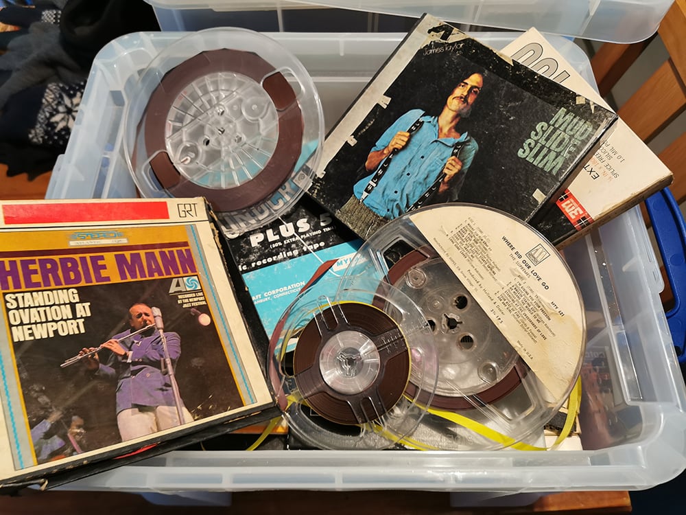

Header image: scandalous treatment of open-reel tapes. All photos courtesy of Ken Kessler.
