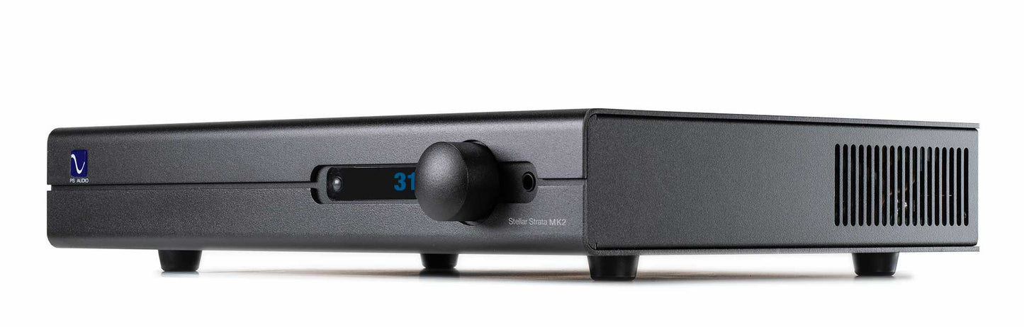

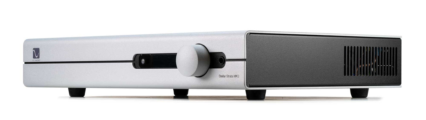

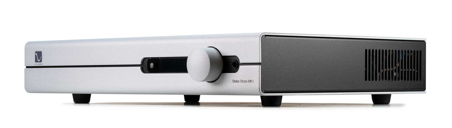

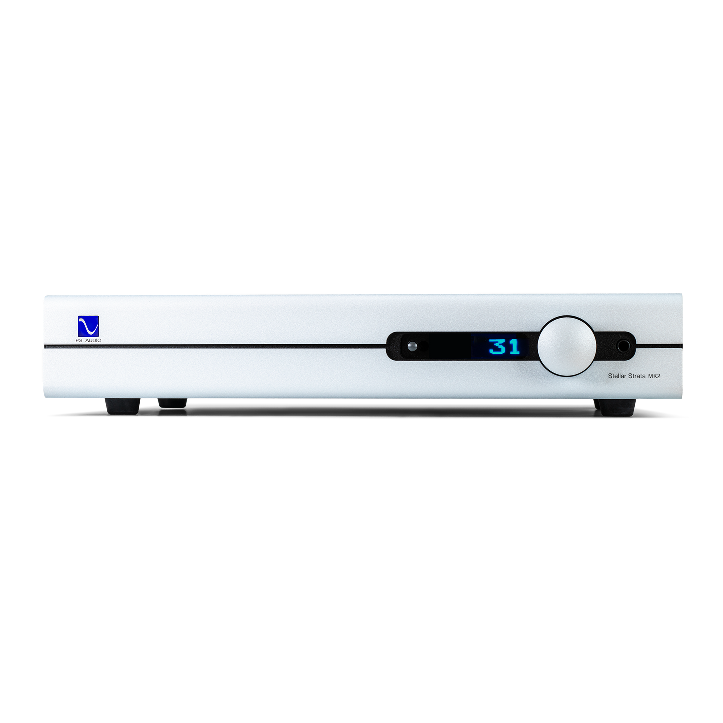

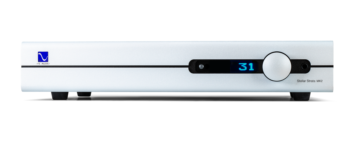

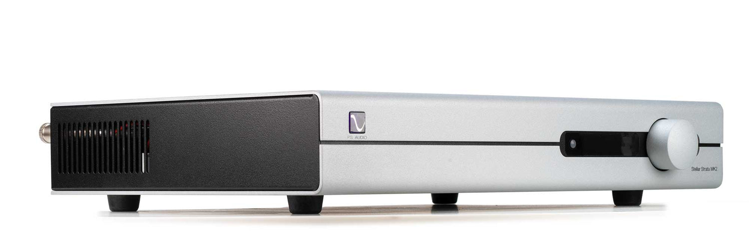

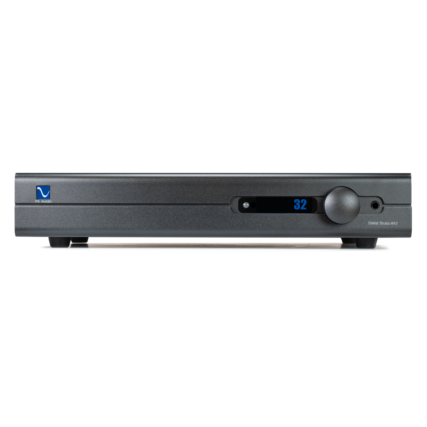

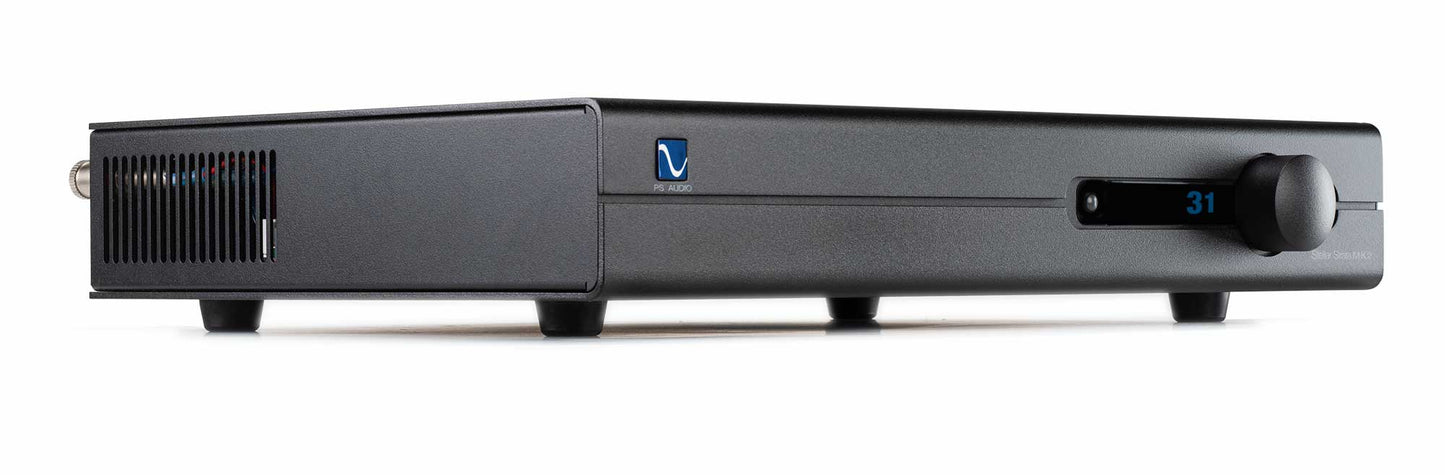

Stellar Strata MK2
The new Stellarâ„¢ Strata MK2â„¢ combines the benefits of an exceptional analog preamplifier, a full-featured state-of-the-art DAC, a stereo 150-watt per channel power amplifier, and an amazing sounding MC/MM phono stage in one gorgeous package.
Strata MK2's fully balanced analog preamplifier circuitry, state-of-the-art DAC, no compromise high-definition phono stage, and MOSFET based power amplifier create an extraordinarily rich, full-bodied musical experience few products can match.
The Stellar Strata MK2 is the perfect foundation for those unwilling to compromise sound quality. <strong>Rich. Lush. Powerful.</strong> A music lover's answer to spiraling cost-no-object equipment without sacrifice.

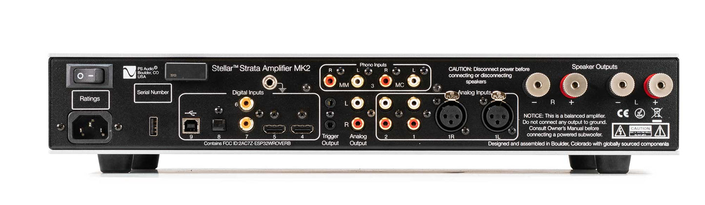

When you first pick up Stellar Strata MK2 Amplifier, you'll notice its solid build and heft. Every inch of Stellar suggests quality: from its rear panel connectors, Darren Myers designed MC/MM phono stage, to its internal high-end power amplifiers. Quality input and output connections, as well as beautifully constructed internals, will offer immediate assurance of quality from the very first moment you pull Strata MK2 out of its box.

 Color Options Black
Silver
Voltage Options Japan 100V (+/-10%)
North America 120V (+/-10%)
Europe/Asia 230V (+/-10%)
Mains Power Input IEC C14
Fuses T250V-250mAH (1/4A Slow Blow)
Accessories Included Remote Control
Line Cord:
- US, JP and EX (NEMA 5-15P)
- Schuko (CEE7/7) (230V version)
- UK (BS1363) (230V version)
- Australia (230V version)
Analog Audio Inputs RCA: 2 stereo pairs
XLR: 1 stereo pair
Phono Inputs MM RCA: 1 stereo pair
MC RCA: 1 stereo pair
Digital Audio Inputs I2S: 2 inputs
- PCM 44.1KHz to 384Khz, DSD64, DSD128, DSD256
Coax: 2 inputs
- PCM 44.1KHz - 192KHz
Optical: 1 input
- PCM 44.1kHZ - 192KHz
USB: 1 input
- PCM 44.1kHZ - 384KHz
- DSD64, DSD128 (native)
- DSD64, DSD128 (DoP)
Audio Outputs RCA (Unbalanced): 1 stereo pair
Headphones: 1 1/4" stereo
Speakers: 2 binding post pairs
Other Trigger Out: 2 3.5mm, 5-15 DVC
USB A: 1 (for firmware update)
