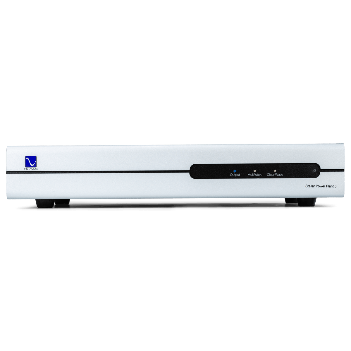

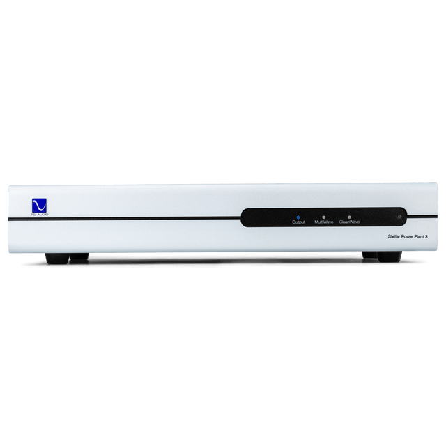

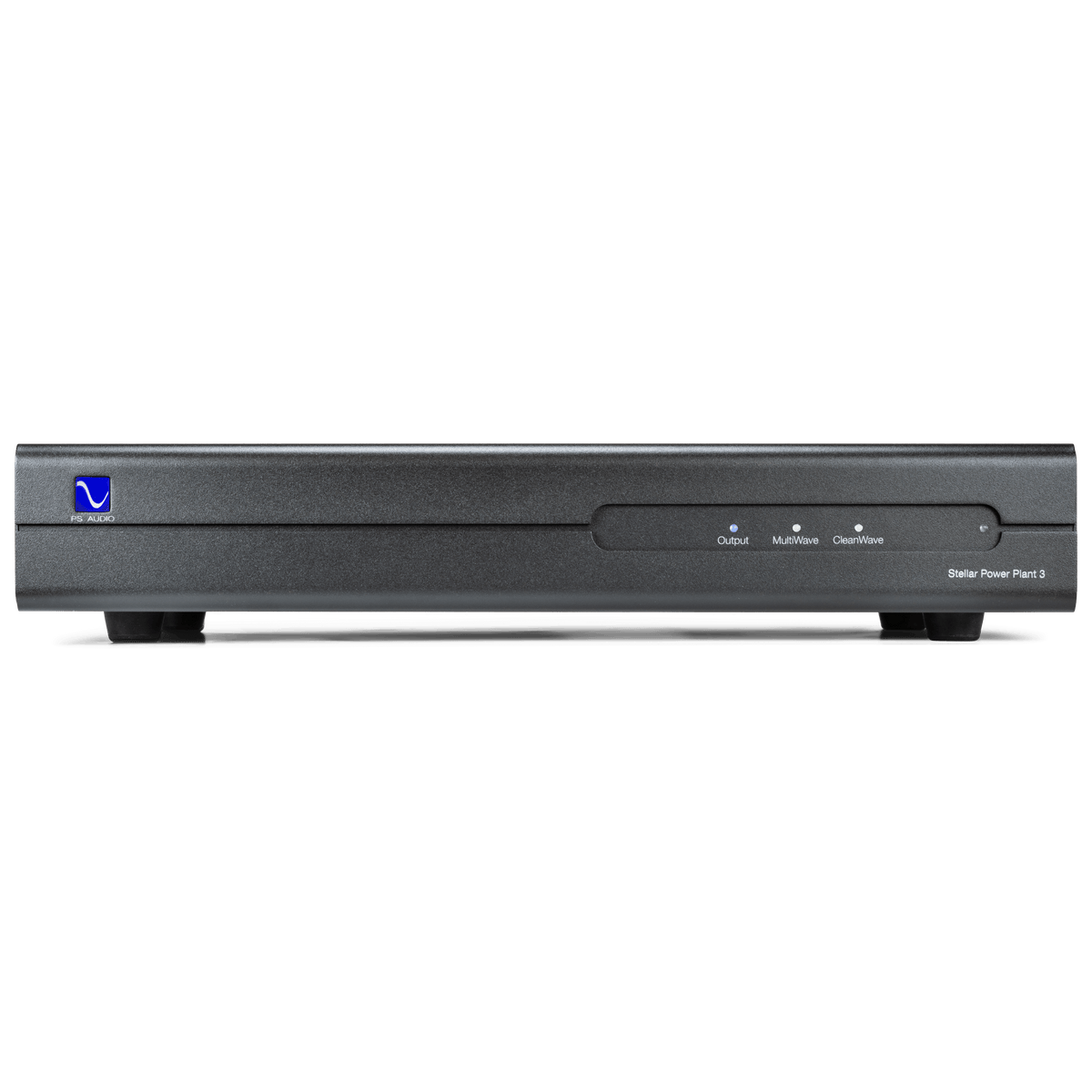

Designed for sources and small systems

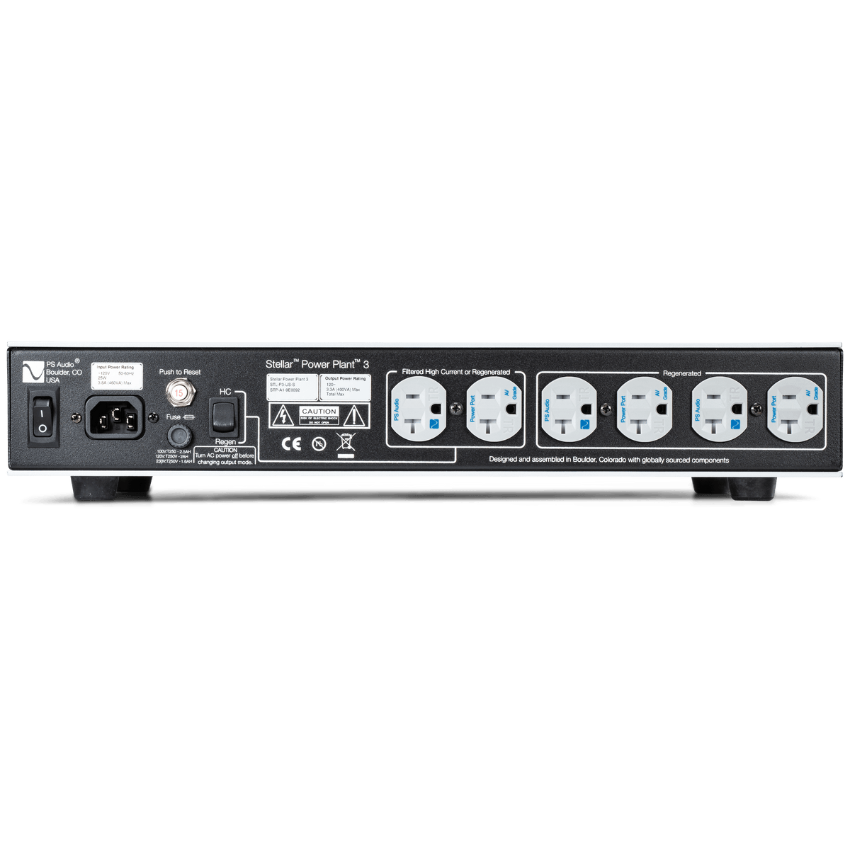

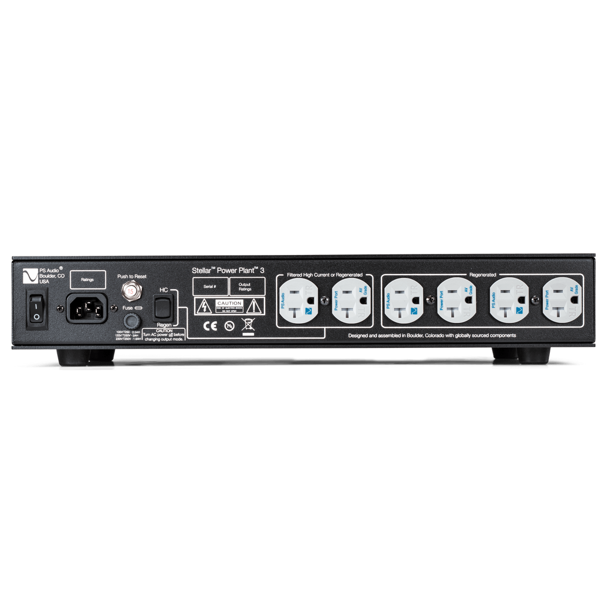

  • Output 300 W · 900 W peak
  • Outlets (US) 6
  • Wall input Standard 15 amp
  • Screen None. Remote control

Features
At a glance
  • Built in boulder
  • 300 watts continuous output
  • 500 watts short-term output
  • 900 watts peak output
  • 1000 watts filtered output
  • 3x lower impedence than p5 power plant
  • 6x outlets US
  • 15amp AC input US
  • Range 95 – 145 vac US
  • 4 eu/au/gr/uk outlets
  • 10amp AC input eu/au/gr/uk
  • 230 volt regulated eu/au/gr/uk
  • Range 200 –285vac eu/au/gr/uk
  • 100% regenerated AC
