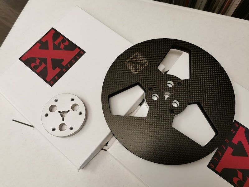

After some months discussing the design with me and others, Kevin agreed that they should look exactly like the gray-finished 10-inch spool. He chose to dispense with any notch near the hub to accept leader or tail to make threading easier because he wanted the balance (evenness of weight distribution) to be unaffected, even by that small amount. He insisted on all-aluminum hubs, with three screws per side (six total) holding the flange to the hub.
Unfortunately, I threw him a curveball when I pointed out that decks of a certain vintage – including my cherished Denon DH-710F – employed a locating peg that requires a hole that is approximately 1/2-inch from the primary spindle. This is not necessary with the NAB hubs of the 10-inch spools because every NAB hub adaptor I’ve seen has the requisite aperture on its back to accept a locating peg.
This is accounted for, too, on every plastic spool I have ever seen, usually with a series of equidistant holes, or the positioning of the aperture for the tape threading. Kevin opted instead, in order to maintain ultimate balance, to design a hub with three equidistant holes.
He arrived with two prototype spools and a hub on its own, and the workmanship was as fine as anything I have seen in machined metal. And cynics please note: the RX spools are made entirely in the US. Even the carbon fiber has a tale to tell: it is truly aviation-grade, as well as enjoying green credentials because Root has found a source for offcuts from an airplane manufacturer, so recycling is part of the process.
The machined hub.
The machined hub.

Alas, I didn’t bother to measure the thickness of the flanges on the prototype 7-inch spools, but I suspect they are slightly thinner than the 2.3mm thick flanges of the 10-inch spools. Other than that, the new spools actually do resemble a scaled-down version of the larger reel in every way, aside from the obvious replacement of an aperture for a NAB hub with the smaller “Mercedes-Benz” three-prong standard to suit all spindles.
