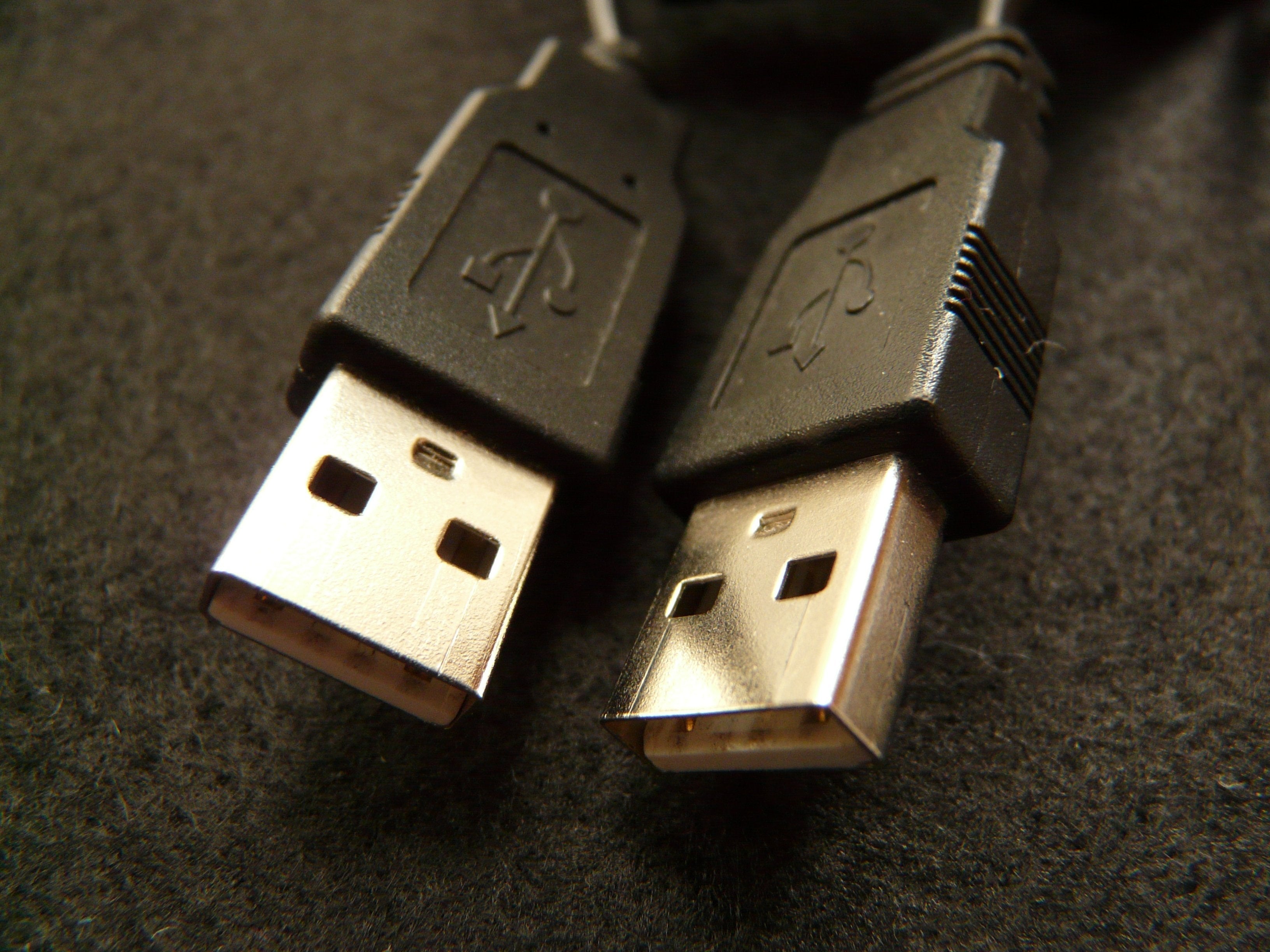

We toss around technical terms so casually that we forget most people never learned what they actually mean.
Ever wonder about a term like USB? Today, it's how we connect just about everything we touch from phones, TVs, electric wine bottle openers, hard drives, DACs—even my shaver's battery is charged over USB.
USB stands for Universal Serial Bus. That much some people know. But what does it actually do when you connect a computer to a DAC, and why should an audiophile care?
The story starts in the mid-1990s when a consortium of companies including Intel, Microsoft, and Compaq got tired of the mess of different connectors cluttering the back of every PC. Serial ports, parallel ports, PS/2 connectors, proprietary docks, it was chaos. They created USB as a single standardized interface that could handle data transfer, power delivery, and device communication through one cable and one connector.
The original USB 1.0 spec from 1996 moved data at 1.5 megabits per second. That was fine for a mouse or keyboard but useless for serious audio. USB 2.0 bumped the speed to 480 megabits per second, which opened the door for high-resolution audio streaming. Suddenly you could pipe a 24-bit, 192 kHz PCM stream or even DSD from a computer to an external DAC without breaking a sweat. That was the moment USB became an audiophile tool.
Here is how it works in practice. Your computer reads a music file from storage and hands the digital data to a USB controller chip. That chip packages the data into small frames and sends them down the cable using a protocol called isochronous transfer, which prioritizes steady delivery over error correction. The DAC on the other end receives those frames, unpacks them, buffers the data to smooth out timing irregularities, and converts the ones and zeros into an analog signal your amplifier can use. The whole thing happens in real time, millions of bits marching in orderly formation from source to converter.
The challenge for audio has always been jitter, the tiny timing errors that creep in during that handoff. Early USB audio implementations were rough because the computer's clock controlled the data flow and computers are electrically noisy, unstable timekeepers. Modern asynchronous USB flipped that relationship. Now the DAC's own precision clock pulls data from the computer at exactly the rate it needs. That single architectural change transformed USB from an audiophile compromise into a legitimate high-performance connection.
Understanding what USB actually does demystifies the whole chain. It is just a pipe for moving numbers from one box to another. The quality of that pipe, the clocking, the electrical isolation, the implementation on both ends, those details determine whether USB sounds mediocre or magnificent.
Why care? I figure it this way. The more you know, the more control you have over every aspect of your system and the music that winds up delighting you.
