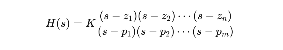

The transfer function H(s)H(s) or H(z)H(z) of the filter is given by the ratio of the product of terms corresponding to zero locations to the product of terms corresponding to pole locations.
H(s)=K(sz1)(sz2)(szn)(sp1)(sp2)(spm)H(s) = K \frac{(s - z_1)(s - z_2)\cdots(s - z_n)}{(s - p_1)(s - p_2)\cdots(s - p_m)}
