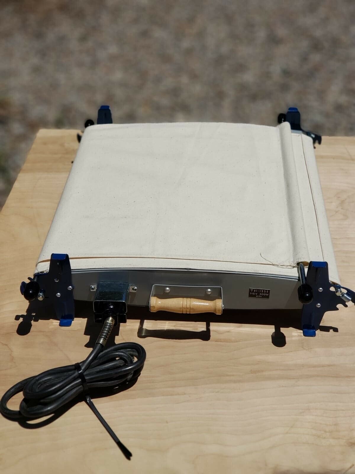

A Ferrotype Plate is a piece of polished stainless steel that looks like a mirror. To use the plate you gently lay the image side of the freshly washed print onto its mirrored surface and with a few passes of a squeegee, press it flat and let it dry. The soft emulsion of the image assumes the mirror finish of the plate and voila! A glossy print.
But it's never quite that simple, right? Even though the plate offers a glossy surface, once dried we still have the paper curling problem. To solve that, one must hold flat the print while it is drying and do that in a way that lets the water evaporate. A canvas sheet is a good way of holding down the print while it is drying. It is a highly porous cloth with good abilities to be tensioned.

My local camera store put on sale for $25 an old electric Ferrotype Plate with a stretchable canvas cover. Between my paper route and the few shekels I had amazed from my job as a cub photographer at the Anaheim Bulletin, I became the proud owner of a contraption that looks very much like this one.
