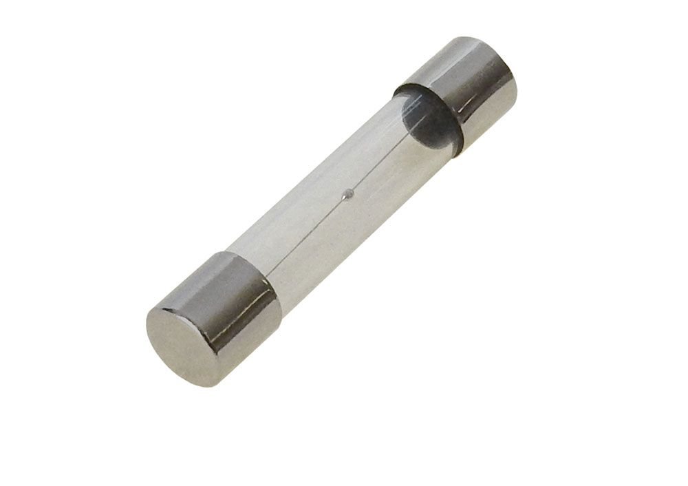

First, let's talk fast blo fuses. You don't see these a lot anymore. They are typically used in the DC "rails" (the power supplies) that feed circuitry. They need to be quick because they are there to stop the voltage feeding circuitry before something bad happens to that circuitry. Their most common use is to protect power transistors in the output of a power amplifier. Where small signal circuitry like that of a preamplifier doesn't have enough "juice" behind it to cause damage to the silicon, a power amplifier surely does. The fuse must die faster than the transistor it is protecting.
A fast blo fuse is basically a whisker-thin wire inside a glass (or ceramic) enclosure. Here's a picture of one.
Fuses are designed into the power supplies that feed the output transistors of amplifiers. They are chosen by their rating of how much power they can pass before the little wire inside heats up and vaporizes—thus breaking the connection to the power supply.
Most amplifiers don't have these because there are now more modern means of providing the quick shut off (other solid state devices).
