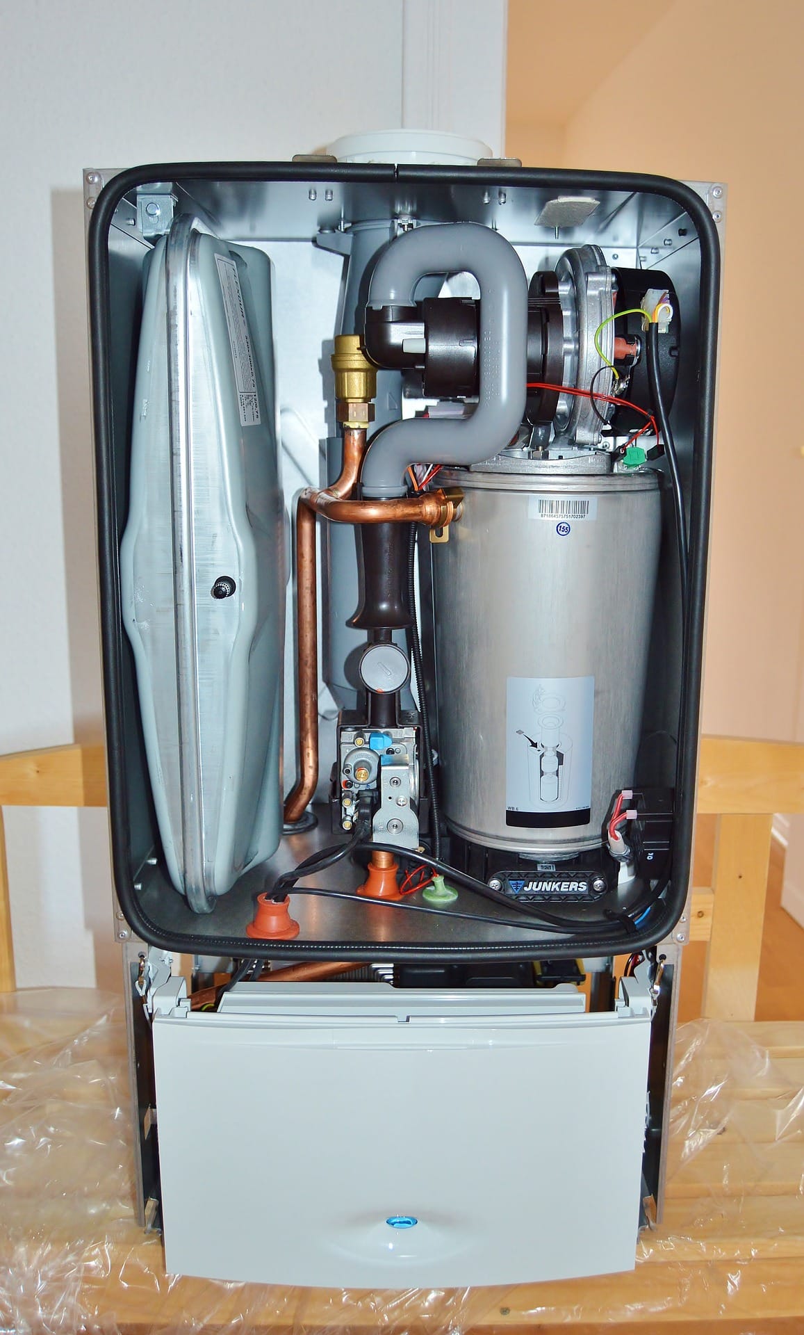

Recently, my home's heating system went on the Fritz. As Murphy will explain, heating systems never die in the summer: always the winter. Several thousand dollars of plumbers later it's still intermittent. Since the "expert" can't figure it out, time for me to put my troubleshooting hat on.
The first thing troubleshooters do is narrow all the variables down to one clear problem. That's easier said than done especially when you don't know diddly about a gas-fired circulating water heater. But, I reason, what's to know? The problem I am experiencing seems more electrical than mechanical. When one of the thermostat zones calls for heat, the circulating water pump kicks in and the burner fires up—only that's not happening. Calls for heat go unanswered and so, at the plumber's suggestion, we replace the controller. It works better but still requires me to sometimes pound with my fist on the machine to get it to work.
I won't bore you more than I already have with the details, but none of my periphery attempts at identifying the problem worked. Time to become one with the machine.
To become one with any machine the engineer has to mentally embrace its operation to the point where it can be easily modeled in one's imagination. For me, it's hands-on. I start with enabling and disabling subsystems to understand how the beast works. Once it's been devolved from a mysterious complexity to the simplicity of subsystems, the machine is essentially a part of your consciousness: you can then apply if/then statements to narrow down the problem.

Oh, and the problem the plumber couldn't figure out and I did? A f***ing loose wire from the temperature sensor on a terminal block (which explains why on occasion I had success beating on the machine).
