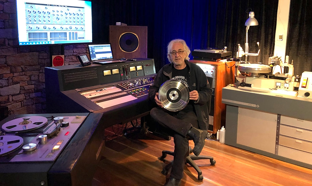

Mike Papas in his Mastering Studio with a Neumann VMS-70 lathe, transfer console and preview head tape machine.

Header image: Mike Papas holding a stamper made from one of his lacquer master cuts.
