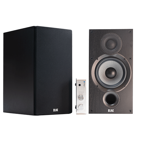

Sprout100 + ELAC Speakers
The perfect music system for any home. Sprout, PS Audio's killer integrated teamed up with a pair of Germany's ELAC loudspeakers and Emotiva cables. Everything you need. Bring this hand selected affordable package into your home today. Sets up in just minutes.
The Sprout100 Elac package brings audiophile sound without the audiophile complications. Sprout100 is an overachiever—a single piece of audio gear offering a wealth of connectivity and great sound in a chassis the size of a hardcover novel. However you like to listen—streaming, LPs, CDs, or digital audio from your computer or game console—Sprout100 is designed to handle it. To match with Sprout100, we hand-selected Elac’s B6.2 speakers. Matching the ethos of Sprout100, the B6.2s are also overachievers, performing far beyond what their price tag might convey. The pair together truly sings, letting you explore your music like you never have before. Don’t worry, we included speaker cables too; you’ll be up and running in 10 minutes or less.
