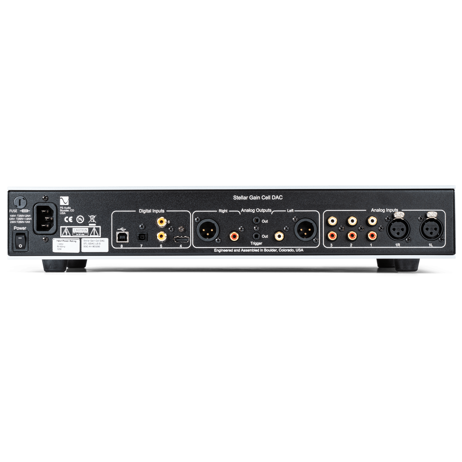

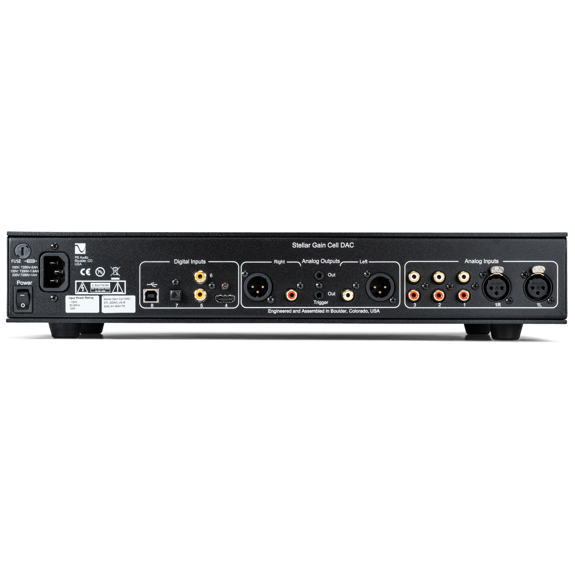

Specifications - Gaincell DAC
Physical |
| Unit Weight | 13.5 lbs [6.1 kg] |
| Unit Dimensions | 17” x 12” x 3” |
| Shipping Weight | 17 lbs [7.7 kg] |
| Shipping Dimensions | 23”x 18” x 9” |
Power requirements |
| Input Power | Model specific 100VAC, 120VAC, or 230VAC 50 or 60Hz |
| Power Consumption | 20W |
| Mains Power Input | IEC C14 |
| Fuses | 100V T250V-2.0AH (2A Slow Blow) 120V T250V-1.6AH (1.6A Slow Blow) 230V T250V-1.0AH (1.0A Slow Blow) |
| Accessories included | US (NEMA 5-15P) (all versions) Schuko (CEE7/7) (230V version) UK (BS1363) (230V version) |
Analog inputs |
| RCA XLR |
3 stereo pair 1 stereo pair |
Digital audio inputs |
| I2S | 1 PCM (384KHz max) DSD64 DSD128 Compatible with DirectStream Transport SACD handshake for DSD playback |
| Coax | 2 PCM (192KHz max) |
| Optical | 1 PCM (96KHz max) |
| USB | PCM (384KHz max) DSD64 (DoP) DSD128 (DoP) |
| Format | PCM, DSD |
Analog Audio Outputs |
| RCA XLR Headphones |
(Analog Unbalanced) 1 stereo pair (Analog Balanced) 1 stereo pair One 1/4" headphone connector front panel |
Analog Performance |
| Gain Maximum output Sensitivity |
12dB +/-0.5dB 20 Vrms 5.3Vrms |
| Input Impedance | 47KΩ single ended RCA 100KΩ Balanced XLR |
| Output Impedance | 100Ω single ended RCA 200Ω balanced XLR |
| Frequency Response | 20Hz – 20KHz +0/- 0.25dB 10Hz – 100KHz +0.1/-3.0dB |
| Noise | 20-20KHz <-90dBV |
| S/N Ratio | 1KHz >110dB (max output) |
| Channel separation | 1KHz >90dB |
| Input separation | 1KHz >90dB |
| THD&IM | 1KHz < 0.025% 20-20KHz < 0.05% |
Headphone performance |
| Output power @1% THD | 300Ω 300mW 16Ω 3.25W |
| S/N Ratio 1kHz Noise |
>95dB (max output) <-80dBV |
| THD & IM 1Vrms out | 300Ω <0.05% 16Ω <0.06% |
| Output impedance | <4 Ω |
Features |
| Volume Control | 0-100 (1/2 and 1dB steps, 80dB total range) |
| Balance Control | 24dB each direction in 1/2dB steps |
| Home Theater Mode | Assignable to any analog input Adjustable (in setup) to any level |
| Polarity (phase) Control | Digital sources only |
| Filter Control | 3 selectable digital filters (PCM digital sources only) |
| Trigger output | (3.5mm 5-15VDC) 2 |
| Remote Control | Yes. Infra Red |
