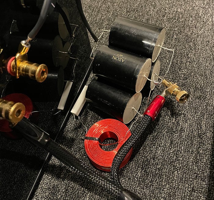

Now it was time to fix the IRSV EMIM distortion problem and make yet another major improvement to this already wonderful loudspeaker system. Chris proposed designing a custom notch filter with a very specific Q, gentle enough not to be noticed, yet high enough to rid the EMIMs of their distortion without touching elsewhere in the frequency band. Once done we would have a hole in our response that would be filled in with the new woofers—drivers more than capable of excellent performance up to several hundreds of Hz ( a feat the old IRSV woofers were incapable of).
Here's what the notch filter looks like:
With this network in place the distortion's gone and the EMIMs have less to do thus helping them sound better overall.
