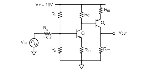

Here’s a picture I snagged off the internet. It’s not entirely accurate because it only has one power supply. For direct coupled you need a + and a – supply with ground sitting in the middle. But, it shows the two-stage amplifier example as well as the two-gender approach (Q1 is an NPN gender and Q2 is a PNP gender, each moves in opposite directions).
