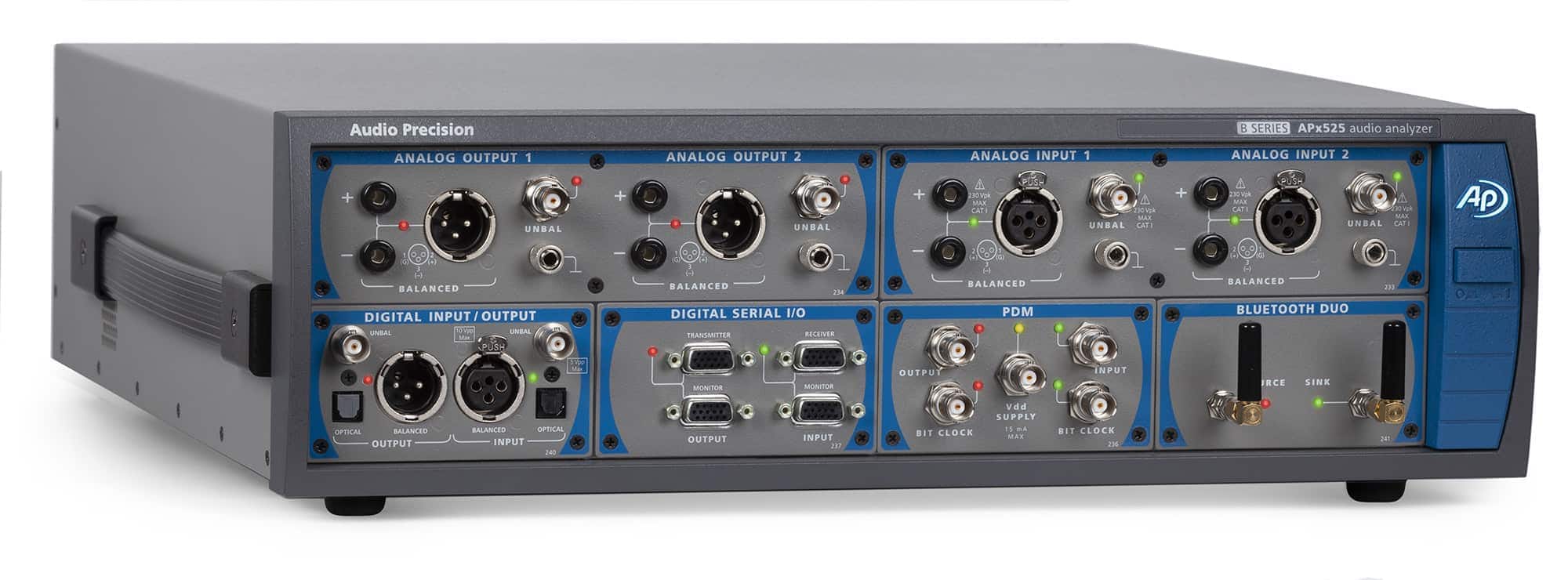

Header image: Audio Precision B Series APx525 audio analyzer.
